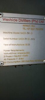

I have a multiple machines in a single zone, which I need to cool, I'm stuck at figuring out the percentage of heat gain from these machines out of the total electric power consumption.
I was lucky yo get the power consumption, the machines are shrink wrapping machines and sachet packaging machines.
I just want to know the average percentage to use for such machines to get the amount of the heat load.
