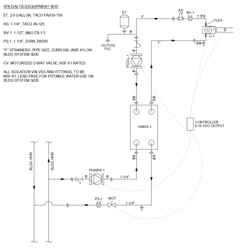

This is how I'd like to pipe in a new heat exchanger into the existing building system. The pump shown is variable speed. I'm concerned that the higher pressure HWS upstream water will push more water through the pump than required when the pump is running at low speed. Do you think this will be an issue? Curious if the pump will "resist" the additional turning of the impeller if the upstream pressure is trying to push water through, when it's running. Thanks in advance!

Thanks for the great responses. I didn't think about cavitation, thanks for that. The CV control valve is just a simple open/close valve; opens when the pump runs and closes when the pump is off so that water doesn't flow through the heat exchanger when it's unwanted. The pump is controlled on a discharge air temperature from a fan coil on the other side of the heat exchanger.
I believe I did think of a solution to this; a pressure sustaining valve after the control valve and setting it to match the HWS pressure. That way it makes the downstream pressure and upstream pressure of the pump the same.

Sorry all, not ignoring you, just had to meet a deadline on another project. Here is the full diagram. This is a case of a PM telling me, "I already ordered the equipment and some of it is on site; can you just draw up a diagram to make sure I didn't miss anything?". Basically the pumps and heat exchanger are already on site so I'm trying to make things work, if possible. I'm currently trying to get some more information but just to answer some questions:
Pressures: trying to get that information but it's likely around 30 psi +/- 10 psi. I agree that it would be good to just connect it directly without a pump but then we would have to buy proportional control valves since we need to dial in the temperature. So I'm trying to make the pumps work if possible, which will be controlled with a 0-10 VDC input.
Why the pump is variable speed: see diagram, we're trying to maintain a 70 °F discharge air temperature from outdoor air that varies throughout the year between -10 and 100 °F.
Sorry for the control valve symbol confusion, wasn't quite sure how to show it.
"CV" (now "MOT") is on/off, yes. Loop pressures could fluctuate slightly, yes. But I believe the BLDG main pumps are set up to maintain constant pressure. HX flow to vary to maintain discharge air temperature.
S/R temps for bldg mains: 140/120. Flow will vary, there are 6 different locations across the building where this setup with occur. 9 pumps, each slightly different flow but all around 20-30 gpm. fan coil side of HX, looking for 138 supply and 108 return.
My conclusion so far is that FacEngrPE is correct about the cavitation issue. I see our options as injecting the return water back into the supply (robbing from it) or providing a pressure sustaining valve ($). Option 1 will require a full bldg review with the maintenance crew there and option 2 will require spending money. I think I'll offer this to the PM and let him choose. Let me know if y'all have better ideas; I appreciate the help!

That was a great idea though, something I didn't think of. Ok, looks like the supply pressure is 80 psi because it's a domestic/hydronic combined system on the building side. I just had a thought, I could probably use a PRV before the pump to take the pressure down and that would be a lot cheaper than a pressure sustaining valve.

Unfortunately, the pressure is not quite high enough to do it with a modulating valve. The on/off valve is controlled by the pump; if it runs, the valve opens, if it stops, the valve closes. The variable speed pump is run off of a 0-10V signal from the discharge air temperature sensor.
Is it the static pressure in the system or the differential pressure at the supply and return tap you are worried about? If you are worried about the differential pressure I would decouple heat exchanger pump from the building pump. The HEX pump will see the pressure differential caused by building pumps as water is moving between points A-B on attached. Do a cross-over bridge and put a primary - secondary connection for HEX pump. The pump will 'see' what ever static pressure in the building is present (as long the isolation valves are open)but it wont' see the differential pressure caused by building pump flow. I would put your two position control valve on the bridge, when you need to heat, this valve opens and the pump can injection any amount of water to the HEX as required, w/ the excess building water bypassing in the bridge. Keep the taps at C as close together as possible so the flow differential between them is negligible.

I like that idea @MTES93. Cross over bridges with the control valve in the bridge. That eliminates the differential pressure concern caused by the main pumps.
Never heard of that combined domestic/heating system. Seems like it would be plagued with problems when there isa large domestic load. I assume that the domestic outlet pipes are connected to the HW Supply lines. That could leave very little flow in the return lines at times and erratic pressures it would seem??? I don't want any part of such a system.
MTES93, that's fantastic, thank you for that! Forgive my ignorance but what is that symbol you have on there with an "M" inside and two antennae? Here is my latest revision.
