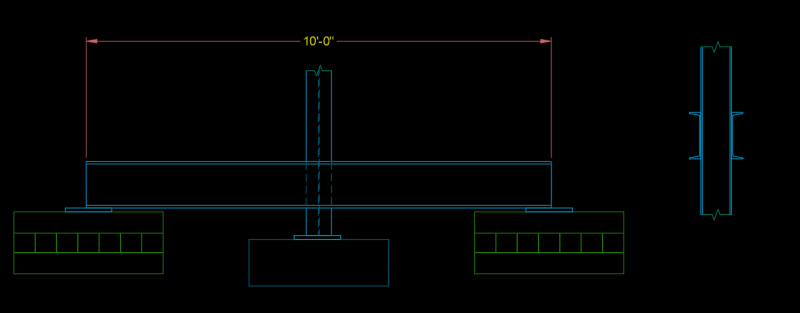

Got a situation where a column needs to be shored to replace a footing. Plan was some channels each side of flange, all welded up as needed. What else do I need to look out for? Obviously check the channels for bending, bearing, etc. Any issues with column? Stiffeners needed?

Post a dimensioned sketch, preferably drawn to scale.

Here is my idea. 20K DL, 10K LL No uplift, not part of a frame or anything. new footing interior, so just below slab. More than likely 12" thick. About a 500 sq trib to the column, bar joists, wood floors. Floor and roof above supported. Figure its not going to snow so min roof live load.
(2)-C12x20.7 channels on the flanges. Column is a W8x24.
Will crib w/ 6x6's each end. One end on a slab, other on excavated soil. Figure about 3'-6" square crib.
Will have them tie the channels together at the ends, weld to a bearing plate too.

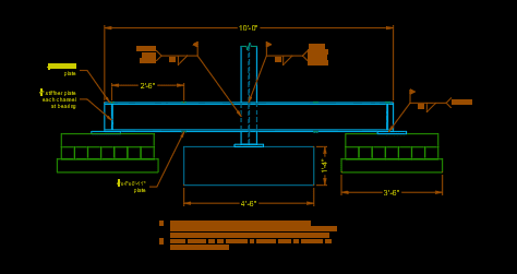

Need to check the C flanges for crippling, the C webs for shear buckling.
Maybe a series of vertical stiffeners for the C’s.
And need more lateral support to keep the C’s from overall lateral buckling.
It seems light to me. But I have not run the numbers.

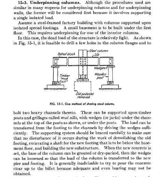

The sizes seems OK. I have a point, you need to transfer the load to the set up with using jack at one side , or wedges to control the deflection of the syst.
The following excerpt from FOUNDATIONS OF STRUCTURES ( BY DUNHAM , 1950,President TRUMAN era. )

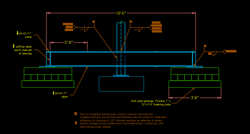

Thanks all. I added some stiffners and tie plates across the channels. Added a note to pre-load to the estimated deflection.
Thoughts?
JStructsteel - The beams will deflect, the cribbing will compress when loaded... top of the new footing will have to be somewhat lower than the existing. Will this lowering of the column cause temporary or permanent problems with floor and roof above?

1) Ten feet long beams are too short for a (theoretical) 10'0" center-to-center span.
First, there needs to be a construction tolerance on the c-to-c span, say, +3".​
Second, beams whose length is equal to the c-to-c span put unnecessary eccentric point loading on the cribbing. From the drawing, a beam length of about 12' would be a better choice.​
2) Size and depth (below ground) of the existing & new footing are not given. The cribbing will put significant distributed surcharge load on the soil. This loading may be too close to the excavation, resulting in unexpected soil settlement under the cribbing, or worse.

1) The beams will have deflected and the cribbing compressed...top of the new (full depth) footing will be lower than the existing.
2) Agreed... now... how about after disturbance caused by removing the existing footing?
3) I am sure... but it's your project.
4) Redraw the sketch to scale, both vertically and horizontally, and post it here. Be sure to show the size of the existing footing located in an (oversized) excavated hole that is 5' 10" deep.

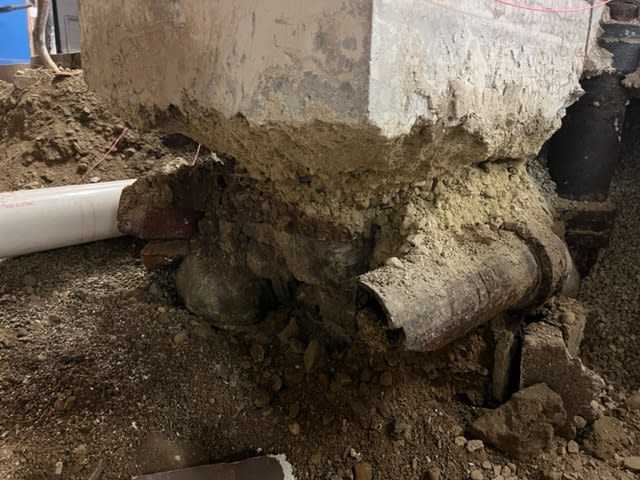

Here is a picture. There really wasnt a footing. It was more slab bearing than a footing. They cut the slab to do new pipe work.
JStructsteel - Grouting can and should be done, but unless the column is jacked (raised) to do the grouting, the column will be lower than it is now. The amount lower will probably be small, say, << 1 in, and this may be acceptable. However, you (engineer) make that decision, it is not something to just ignore or "pretend" is not a potential problem (say, roof ponding).
Eccentric loading, yes... more or less, the assumed point load from the beam will be off-center. Again, this could be minor... but it is easily avoided by using longer beams. Don't take any risks that are unnecessary. Also, eccentricity may NOT be minor if the cribbing is not level... a real possibility.
Redraw, to scale (horizontal & vertical), one thing for sure, the first two sketches are clearly inaccurate. We need to see exactly what you are dealing with... a picture is worth a thousand words.
Show the existing ground line and top of concrete slab on this drawing.
What about the "top of the footing will be 4' 6" below grade" plus 1'4" thick?
That must be the new footing?
Draw a separate scale drawing showing the new footing. There may be significant (geotechnical) "challenges" to overcome in that case.
