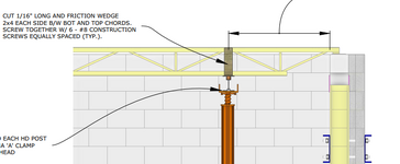

For this kind of situation I've generally used post shores at a convenient location beyond the wall, and installed blocking friction fitted b/w chords. Similar to Bones setup in this thread. If you require additional stability you could use frames or PERI MP props w/MRK frames.
EDIT - You'll need to give the workers some room to facilitate the demo + install. 8" may be enough or may not be depending on what they need to do and if they can access everything from the outside. If they don't need the interior space your idea of a wall is a good choice since it could also double as their hoarding for the demo area.

@Enable: it's a spiffy detail but, fundamentally, what makes it better / more stable than just putting in cross braced shoring at the location shown below?c01.JPG
Kind of depends on the situation at hand but, when I do this, I usually do it by inspection. I also usually specify that the shoring itself have x-bracing. That way the shoring itself can brace the bottom chord right where the stability demand would be the largest. After that, it's pretty much down to whether or not the last tension diagonal can handle the tiny amount of compression implied by the very short cantilever. Unless it's made of floss, it surely can. Heck, the top chord alone could probably just cantilever.

I agree with @KootK that shoring at the last bottom chord panel point should be fine in most cases for the reasons Koot has stated. Namely, the last compression diagonal is already a compression diagonal, and the last tension diagonal should be plenty strong enough in compression to handle the small amount of load reversal likely to result from shoring the bottom chord at this location. Directly shoring the bottom chord has the benefit of being simple and expedient.
However, I also really like @Enable 's blocking detail.
