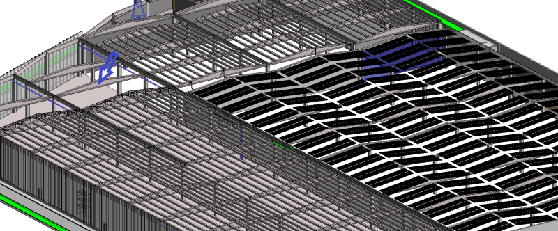

Dear ALL,
How we are supposed to determine the beam height if ve have the beam which has variable height in longitidual direction. This directly will affect the D/H ratio which is one of the governing case for smoke detection installations, but I couldn't found in elaboration on that in NFPA 72 Chapter 17, your guidance will be appreciated.

Can you post a simple diagram of what you have
Please check the precacst girders marked with blue arrow below, they have variable height near the column they are 46cm and at the mid span 165cm, in order to decide the beam height how about if I take the average of variable height of that precast girders as (46+165 ) = 105cm ( beam height )
Bottom level of precast girder is: 800cm
Ceiling Height at mid span is: 1050cm
ok thanks for helping,
then each trapezoidal corridior in transversial maner will be treated as pocket and smoke detectors need to be provided the per pocket, total length for each bay is 120mt.
Or If we can use the air sampling which I believe is very expensive,
which one would you use if you were in such situation ?

Hummm seems like might get false alarms with smoke detectors???
They don’t want duct detectors???
Or
Are there HVLS fans involved and need to shut them down??
Maybe need a discussion on why wanted and where?
If installed should meet NFPA 72
Have you done beam detectors before?
Do you have a fire alarm buddy to consulte?
