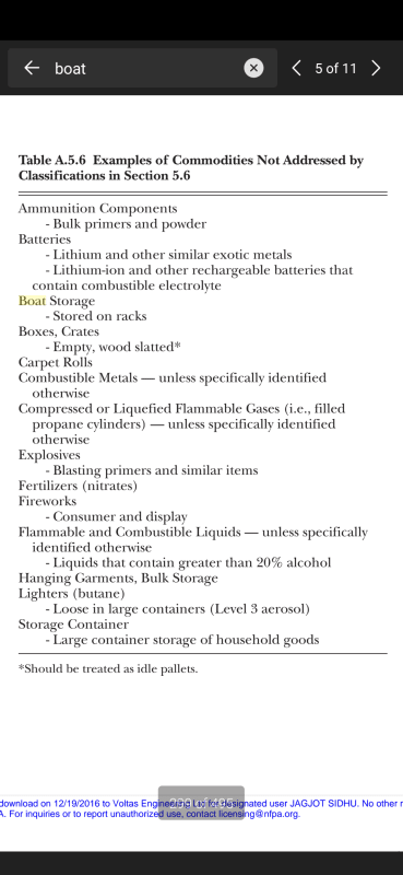

We have found a head k 28 factor which allow us to go to 48 ft ceiling and 43 ft storage. Can someone guide me how to get around the A5.6 exclusion. My understanding of the code states that NFPA doesn't have any guidelines for storing household materials in boxes stored in a warehouse. What kind of a sprinkler system do we need to go for then?

We designed an ESFR system using k 28 heads.
During the coordination stage the contractor pointed out we can't use the ESFR system for containers storing household items, as it is an exclusion from NFPA 13 commodity classification.
I'm not sure what exclusion are you talking about. Section 3.9.1 does not exist.
Also I am not aware of any exclusion about household commodities imposed by NFPA 13. The standard does not exclude commodities based on the occupancy the items belong to rather combustibility, type of packaging and type of storage.
The last one. Large storage container.

The commodity referred to is from the fire code
“”” It should be noted that the International Fire Code (IFC), 2015 edition also includes a list of classifications for commodities, which differs somewhat from that in the NFPA 13. However, the American Fire Sprinkler Association has pointed out that the IFC is far broader in scope than the NFPA, and that it is more appropriate when addressing overall fire protection requirements for a building. However, when it comes to the design, installation of sprinkler systems specifically, the requirements in NFPA 13 apply“”
samples on Commodities Not Addressed by
5.6
Storage Container
- Large container storage of household goods
U-Haul or other storage companies are going to need to get some full scale fire testing done to get the criteria for this stuff.
