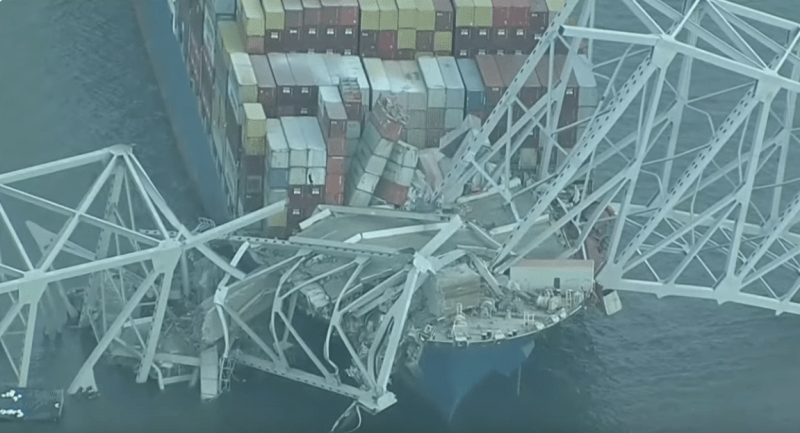

Form what I could see off the video it looks like the ship hit the tower and basically lifted the structure off the supports causing instant global collapse. Ack in t h e 1970s you wonder what sort of hazards were considered and how to stop ships crashing into the bridge. There are some big buoys or may e stations visible but not enough clearly.

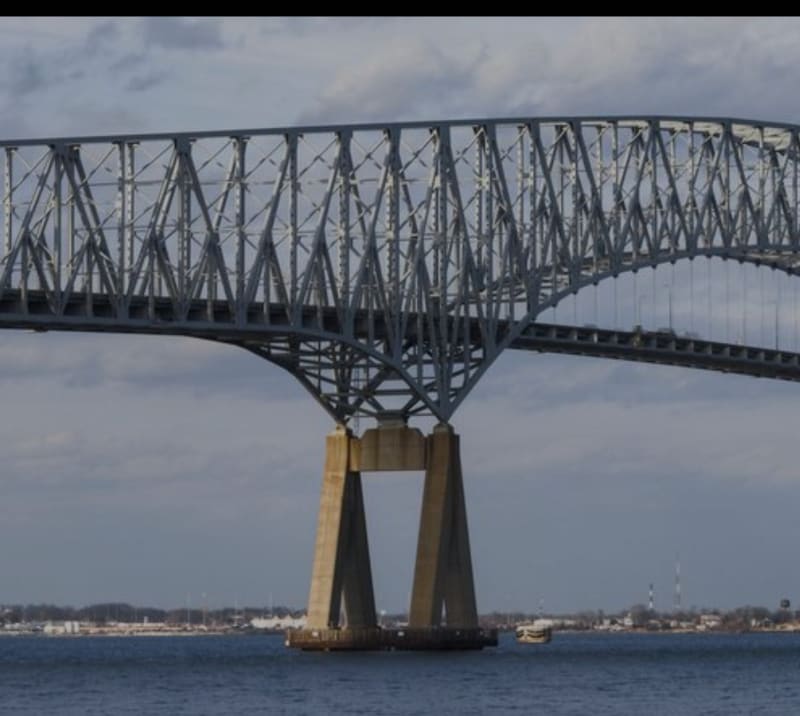

Maybe it's me, but this design looks to be particularly susceptible to collapse in the event of a collision with what appears to be gravity based resting supports onto the concrete pier. A full steel structure going down into the caissons would have given some resistance?

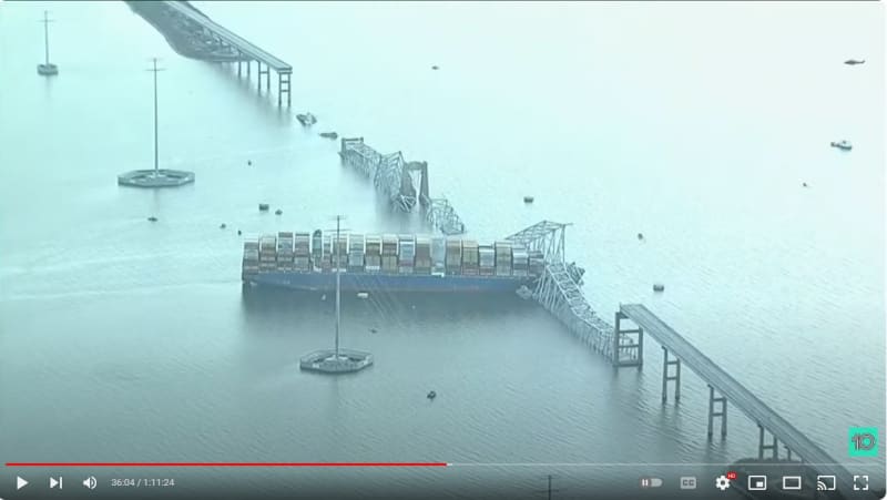

After the impact one pier remains the other was demolished.
The demolished pier does not seem to be able to withstand an impact by a containership. This looks like an under-design. If that is the case the bridge could have been protected by installed extra stronger piers before and after the weak pier to withstand the containship impact.
The bow reached over the pier and took out the support. Same as when a ship gets sideways at the dock and the bow takes out cranes. The bridge likely would have survived if the ship behind the bow had side swiped the pier.
