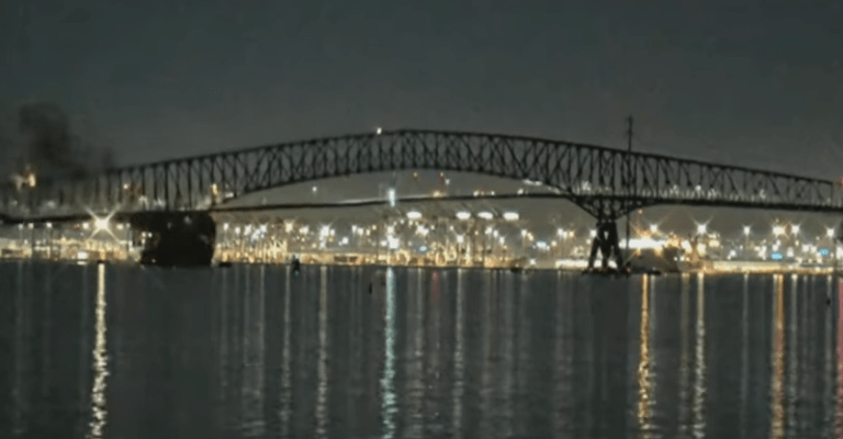

This photo depicts the deck was sinking in a straight line over the demolished pier. This is important as it could only occur if the pier was pushed away or knocked out underneath the bearings. Thus the pier structure has almost zero resistance against such impact. After the collapse the bridge and the broken concrete columns all resting on top of the bow of the container ship.

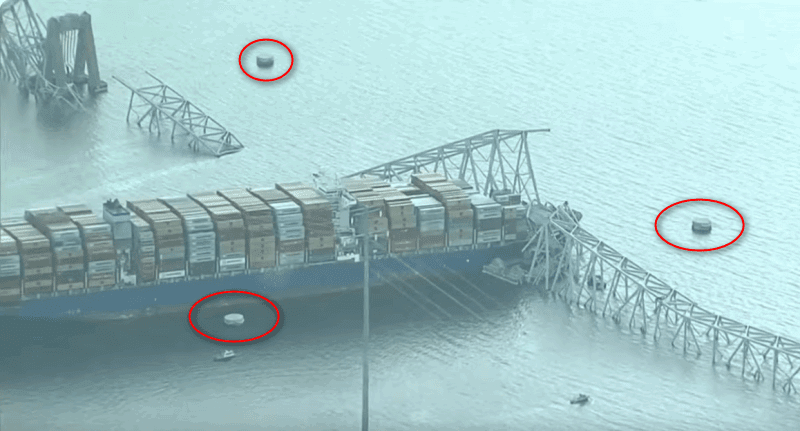

Looks like it just missed a dolphin:

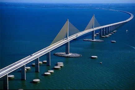

After the Sunshine Skyway Bridge disaster they went all out on the protective dolphins on the new span:
