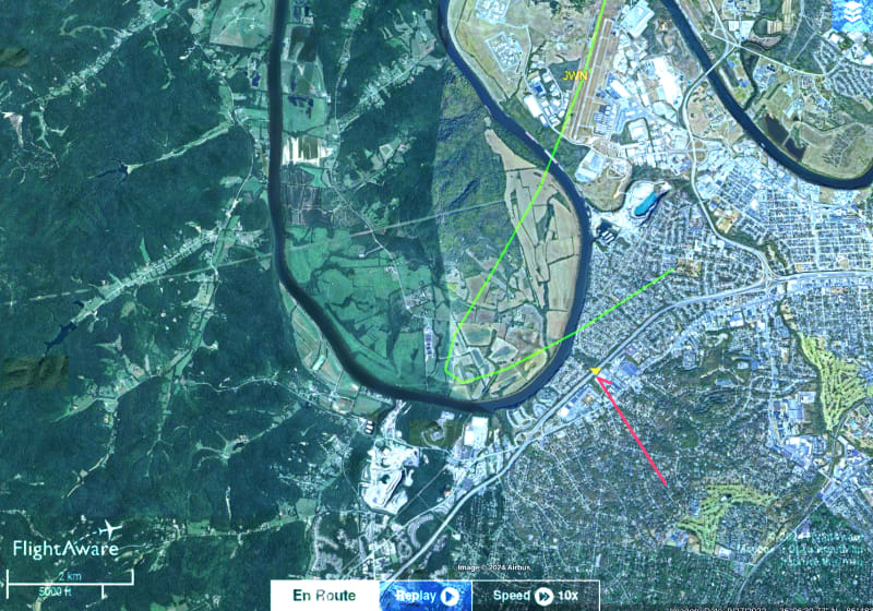

Thanks for the responses. I agree with Littleinch that the spike is likely an anomaly. I don't recall seeing anomalies with other tracking data over the years but should have been able to figure that out.
This crash occurred just after dark and with the overlay, it can be seen that options were limited if not hopeless for an unfamiliar pilot. It would be difficult to discern the extent of the fields below and at 7:40 p.m., there would be plenty of headlights on the roads discouraging a road landing. From the data and news reports, the engine quit just after the pilot crossed the field, a very inopportune time to make adjustments. An extended glide would not seem friendly either so the freeway below may have been his only hope.

I'm surprised the tracking is so far off the crash location.

The choosing the plan is vastly more complicated at night.
That looks like a pretty vicious turn though. The spin idea is sounding quite likely here. Especially with no power.

Was he trying to do a left hand circuit to land on runway 02?
