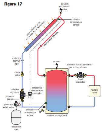

Regarding solar known manufacturers like Reflex, Caleffi etc. say in solar should be inversely. I/m still trying to find out why [bigsmile] though. Maybe something else than pump cavitation prevails (e.g. minimise pressure into the collectors which on the other hand favors evaporation combined to high temperatures-beyond 100°C).
Can yo cite the source? There may be more context needed.
Right here Caleffi show the Expansion tank upstream of the pump right on the cover page
Here they show it wrong in some locations. They sell this solar station with it being wrong. My best guess is the pressure in a solar system is so high that the negative pressure at the pump inlet doesn't matter. and that is a variable speed pump.
the only real difference in a solar system is that temperatures can be quite higher than in an HVAC system and the system is under much higher pressure. Pressure will be especially high if the tank is in a basement and the panels typically on a roof. That's why they get away with doing it wrong. Hope no one has a situation where the tank and that solar station is above the panels.

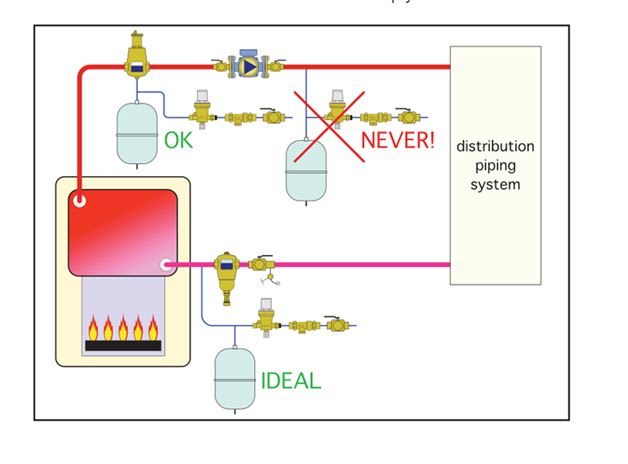

Caleffi also say this
And their picture above with the boiler also is not 100% OK. They show the location at boiler inlet as ideal and the one at pump inlet just as "OK". I assume this is to protect the expansion tank from heat. What they should do is have both the pump and the expansion tank at boiler return. The pump also doesn't like heat. Basically "Expansion Tank - Pump - Boiler inlet"
It wouldn't be the first time manufacturer does something wrong. Aerco boiler manuals had the primary pump on the wrong location for a long time. if you really want to do what their product seems to suggest, you should contact Caleffi and specifically ask.

In solar applications it looks like the expansion tank is located on the pump discharge so under no demand conditions when the fluid in the collectors boils the expansion tank is in direct communication with the collector and not behind the pump discharge check.
"Because all pressurized systems have the potential to “steam-back”, it is considered a best practice to install the check valve on the return piping (going back to the collector) and to locate the expansion tank above the check valve. When a system goes into “steam-back”, steam forms inside the collector and pushes any remaining fluid down through the return line and ending up in the expansion tank. Therefore the expansion tank must not be isolated from the collector on the return line (flow to the collector)."
The check valve isn't relevant here since the expansion tank is connected to the collector through the return side of the loop (from collector through tank).
and the expansion tank isn't sized for boiling water. It is sized to accommodate expanding liquid, not steam. Steam has 1600 times the volume of water. I don't want to imagine the size the expansion tank one would need....
Unless there is a stated reason why it is better, I wouldn't trust Caleffi on this one. Here this from Caleffi as well:
Maybe Caleffi just determined at the high pressures in solar system it won't matter. but the pump inlet still is the better (safer) choice unless there is a good reason(which we still don't know)
