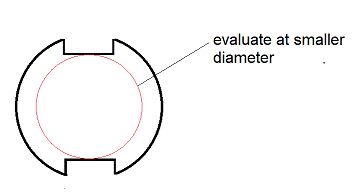

Thanks for sharing your points of view. My doubt points to what 3DDave said, I am not concerned about the load that the 2 keys can carry but rather the reduction in the area of the shaft.
If i add a third keyway the "active" area on the shaft will be reduced and i do not know how it impacts on the new allowable torque. At the very begining of the keyway there is neither key nor coupling just grooves/keyways on the shaft and i supone this diminishes the torque capability.

Also, if you cannot find the stress concentration factors, you might consider evaluating the shaft at the keyway by just looking at the diameter of the shaft between the keys. The geometric difference in moment of inertia is probably greater that the stress concentration factor that you would apply.
