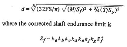

The failure is the result of the maximum principle tensile stress causing the fatigue and that tensile stress is the resultant of both the over hung load and the torsional stress due to the torque. So with the information about torsion the principle stresses can be calculated using a mohr circle. At least that’s what I think.

This link explains what I have been saying, the combined bending stress and shear stress from torsion are vectorally added.

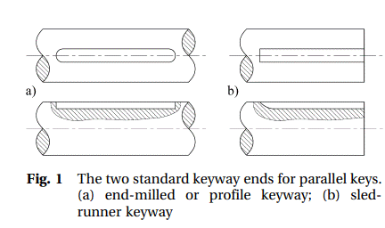

This D shape has some similarities to a keyway
There are 2 traditional methods for machining the end of a keyway as shown at figure 1 page 2 here (a) end-milled or profile keyway; (b) sledrunner keyway
I think each of these would have an analogous approach that could be applied towards transitioning from the D shape shaft profile to the circular profile.
I'm not sure which is the more favorable reduction in stress concentration.
geesaman.d said:
Or rework them yourself, and make sure that the rework operation leaves the machining lay marks in the axial direction of the shaft, not across the shaft.
That sounds similar to the sledrunner approach to me
EDIT - I wonder if the end-milled might be doable without removing the rotor to save time? EDIT 2 - although I guess rotor needs to be held more stationary than bearings can accomplish and not sure how much load we want to put on the bearings. Maybe a chuck on end of shaft would help those things, or maybe it's just a bad idea to even attempt machining the shaft without removing the rotor (I leave that to others more mechanically inclined than me to decide).

Tmoose - I can't read your link. But I wonder if end milling using a radiused bit would give a favorable reduction in stress concentration.
Just a dremel and a grinding bit and 30 seconds or less would ease that sharp stress riser. Not even a lot of skill - just erase the corner and stop.
Dremel is suitable for the sledrunner. It would probably require disassembly of the motor to get enough working room for the wheel that close to the motor frame. But maybe disassembly is inevitable anyway? (I wondered about that in "edit 2" of my post timestamped 17:18)
Using a radiused end mill to cut the flat would be a improvement but geeaaman brought up the direction of the surface finish. Utilizing the side of the mill would provide the correct orientation of finish.
However, these solutions would require manufacturing new motors with correctly specified shaft features. A little hand finishing can be done in the field and *may* solve the problem.

Yes, I'm advocating for a sledrunner type end finish here. And the machining/grinding lay marks be axial, which is normal for a sledrunner cut. I think that and reducing the bending moment will put this to bed.
