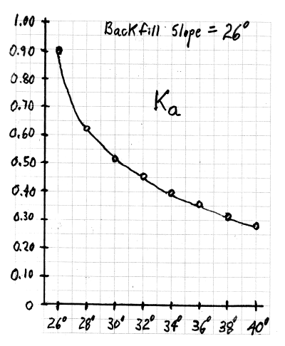

I would use one set of soil properties assumed to be equivalent to the combination of 26o, 28o and 40o friction angles... and this would not be just a wild guess:
1) Start by bounding the problem, both upper and lower bounds. That is, Ka at both 26o and 40o.
2) Then determine values for several friction angles between 26o and 40o.
3) Plot the results and see what what comes up:
From this graph, Ka is pretty sensitive to changes in friction angle between 26o and, say, 32o. From 32o to 40o, not so much.
4) Using engineering judgement, I would assume an equivalent friction angle of 34o... and that is is for worst case sloped backfill that extends an infinite distance horizontally... which is not the case. This is broken slope backfill, not as "bad".

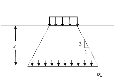

5) For the assumed uniformly distributed surcharge loading from the carriageway, use the 2:1 slope soil loading assumption to "bring down" the elevation where this load is applied to the elevation of top of retaining wall:
6) Then use the appropriate Boussinesq equation with calculated loading at top of wall elevation to come up with the carriageway's loading on the wall.
