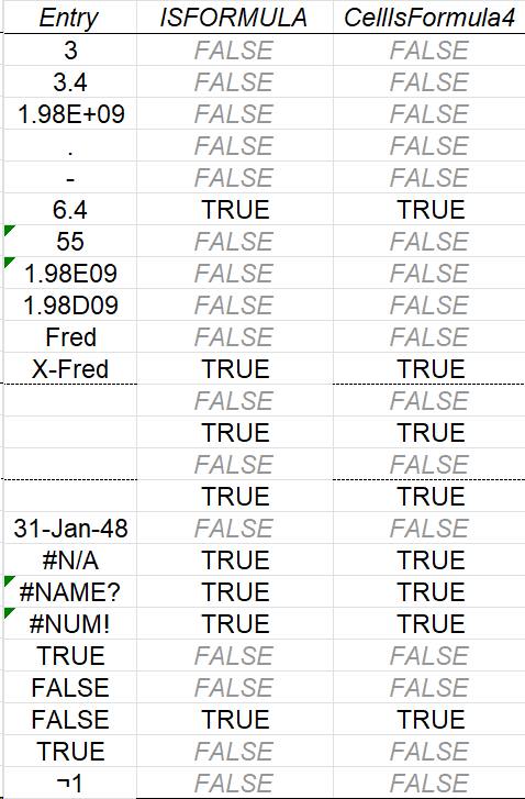

Many (MANY) years ago, I attempted to set up a systematic test to establish exactly how Excel's various ISxxx() functions responded to the various types of arguments that might be thrown at them.[ ] I have added MJ's CellIsFormula4() function to that tabulation.[ ] It passes all the tests I could think of at the time I made the spreadsheet.[ ] See attached.

I managed briefly to get my fingertips onto a computer with Excel-2013 on it, and loaded my Testing_Is_Functions.xls spreadsheet onto it.[ ] I then added a column for the ISFORMULA() function.[ ] Comparing the results from ISFORMULA() and CellIsFormula4() the following cell contents gave different results.
.[ ] (Just a single, lonely decimal point)
'55
'1.98D09[ ] (but not '1.98E09)
Fred
=T(5)
=NA()
=Fred(A4)[ ] (ie a non-existent function)
=SQRT(-1)
=(A4=A9)[ ] (where A4 did not equal A9)
[ ] [ ] [ ] [ ] [ ] [ ] [ ] [ ](I didn't think to test the case where A4 did equal A9)
In all these cases I think ISFORMULA got it wrong and CellIsFormula4 got it right (although a few are arguable).

In all these cases I think ISFORMULA got it wrong and CellIsFormula4 got it right (although a few are arguable). said:
hmmm... Excel 2021 had the same results as CellIsFormula4 for all those cases.
TTFN (ta ta for now)
In order to get results for the ISFORMULA function, I sent my test spreadsheet to a friend with a more recent Excel version and asked him to do the testing.[ ] The results I reported two posts up come from what he reported back to me.[ ] I have since established that he uses Excel[ ]365.

I had a quick look at the download spreadsheet and found that for:
=PI()+1
or just =PI()
The Excel ISFormula function says it is a formula, but CellIsFormula4 says it isn't.
It seems to me that any short formula returning a floating point value will be found to be not a formula by CellIsFormula4
