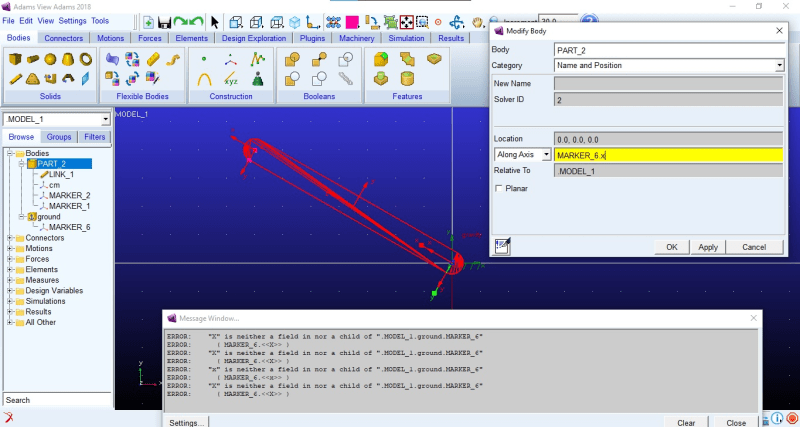

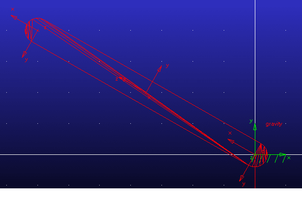

Hi everyone,
I'm currently facing an issue with changing the orientation of a body in ADAMs. Specifically, I'm trying to make these bars horizontal without relying on mathematical relations, especially in more complex situations where that approach becomes impractical for me.
My goal is to place these bars along the x-axis (global) or at a 30-degree angle from it.
Any suggestions or solutions would be greatly appreciated. Thank you in advance.

Didn't catch what do you mean by "creating co-ordinates", but I can create Markers (Little Arrows in Picture below), but how to use them to rotate the bar, I don't know :(

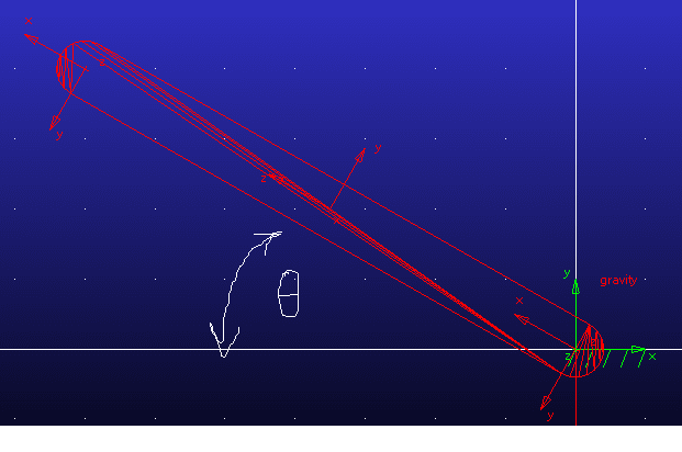

by mathematical relations, I meant , for example, I don't wanna calculate the point, which bar would relay an, when it has a 30 degree relative to ground. (horizontally position needs certainly not any calculations )
I'm more confused by defining this angle and change it :
I've tried this, but doesn't work.
select bar > modify > Position

@rb1957 MARKERS are local reference frames at a specific point, thus they have 6 attributes. The 3 translational ones being the same as a node, and functionally used in the same way.
@OP Have you done the Getting Started exercise, I think it is called Latch? If not, do so, rather than messing about. If you have, do it again.
