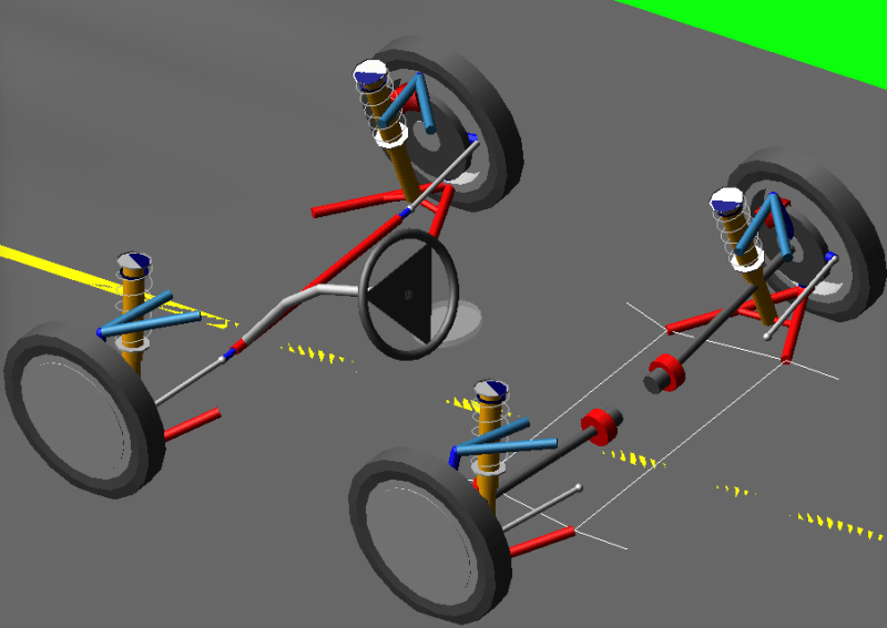

Hi everyone,
I am trying to learning a while Adams Car. I read and done a lot of training pdf's but i can't figure out how i can deactivate a shaft from double wishbone suspension system in template builder. Should i deactivate general part or construction frame or what? Yes there is double wishbone suspension system subsystem without shaft in subsystems folder but i want to do this myself. How can i do this or is there a any document you can recommend for this?
I will glad for your answers.
It looks like you're set to have the part deactivated. You can reactivate it by checking the checkboxes in the dialog shown in the screenshot. Does that answer your question?
Are you working on a particular tutorial?
Hi Alex,
I just use same double wishbone template for front and rear suspension system. but i used fixed joint for rear tierod.
I have 3 years experience from Adams View but now I'm working particularly full vehicle tutorials in Adams Car.
Thanks for answer.
