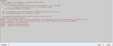

When I try to put mu coefficients of 0 in the old interface simulation, this is the error message:
Photo 6
So what I was keep the my static to zero and the mu dynamic I put 1e-09, but the simulation failed and I got this message:
Photo 7
I guess that there has to be an error on the way I put the joints or the intial speed in the old interface? I did not do the latch tutorial I was following what we were doing in class, so I guess I should start using the new interface for now onwards? It's strange because the joints in the new interface also have a mu static and mu dynamic of 0,5 and 0,3 by default.

In your original post, it is written ".....static friction coefficient must be greater than or equal to 0 and that the dynamic one must be greater than or equal to the static one..." It is odd to have a dynamic coefficient of friction greater than a static coefficient of friction, normally it should be less.
Good point. The example in the solver manual has it the right way round
FRICTION/102, JOINT=102, I_YOKE
, Mu_Static=0.03, Mu_Dynamic=0.024, Stiction_Transition_Velocity=0.1, Max_Stiction_Deformation=0.15
, Pin_Radius=12.25
, Friction_Arm=8.2
, Effect=All
, Inputs=Reaction_Force
The reason this must be so is that in the limiting case, a force just greater than static friction would start to move, and then hit the dynamic friction, and stop.
Also it might be an idea to read the ERROR message, it does not say what you said it siad.
