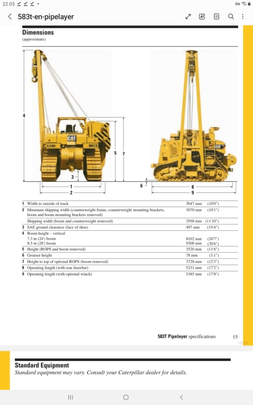

Load and Height is not the problem. 20ft width is tight, but not impossible.
583
