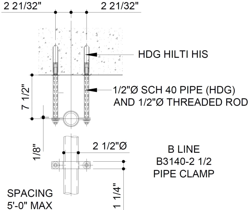

Is SS316 better than SS304 for corrosion when subject to road salts? Is there a better material that is reasonably inexpensive?

Thanks, tug... The hanger assembly is located underneath the bridge in a bit of a sheltered location. I don't expect it to be frequently wetted, but there could be a lot road 'mist'. The bridge is located in northern Canada, and I suspect traffic will be somewhat subdued.
You have described the worst case scenario. Infrequent wetting implies drying which may result in chloride induced stress corrosion cracking. I have seen cold drawn bar fail without any load applied due to residual stresses.
The sheltered location means there will be no washing from rain or other sources. Again, this is a problem. Stainless steels require cleaning in order to remain stainless. Any deposits on the surface will initiate crevice corrosion.

Thanks... I'm looking into 2205... I knew that regular stainless has a problem with chlorides, but didn't know it was that severe. I'll also look into fiberglass and HDG as an alternative.
The duplex alloys eliminate SCC but are still susceptible to crevice corrosion. It appears to be much more resistant to crevice corrosion than 300 series alloys but all studies I can find refer to a submerged sample. Being in open air is a much more challenging condition. 2205 should be acceptable provided you can keep everything clean.
Thanks, tug... I'm leaning to HDG and fiberglass or 2205 as a possibility. I think the HDG is quite a good solution; I'm familiar with HDG and road salt effects. The conduit hangers will likely be in place for years. They are out of the way, and will not likely be 'inspected' once they are installed.

Thanks Ed... looking at using HDG Cooper B Line, something similar to below. I have to get some material thicknesses. Load is only 25lb per hanger or thereabouts. Contained cable is fiber optic stuff. I'll also include a requirement that this be 'inspected' every 5 years, or so. This is the current rendition.

thanks, tug... I'm still waiting to find out what type of salt they use... if regular chloride, I'll likely use HDG if more economical. If they don't know, I'll likely go with fiberglass. Loads are really light, but has to be hung down from the U/S of the deck by 6" or so to clear some other conduits. For pulling the fiberoptic, they want to keep the run as horizontal as possible.
First comment back from the client is that the conduit is on the U/S of the deck and not exposed to deicing salt... I suspect there is a light salt mist that accumulates...
