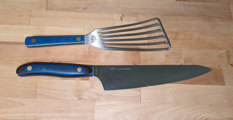

Garolite is the Cadillac of pre-formed epoxy shapes. I even have a kitchen set with Garolite handles [lol]
