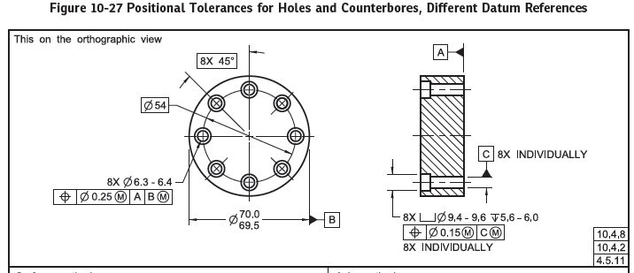

The alternative is this:
Which represents a method for accepting manufacturing convenience variation if the holes and counterbores are done in separate setups, such as an operator doing the counterbores by lining up a drill press by eyeball.

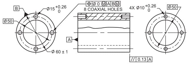

The 3rd example is exactly the same as your case, the two 4 hole patterns have different size.

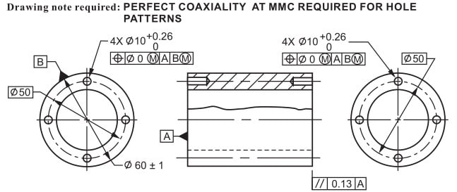

Of interest is the note above the second example - "Drawing note required: PERFECT COAXIALITY AT MMC REQUIRED FOR HOLE PATTERNS". How does the source explain the reason that such note is needed there? The two hole patterns are at a Simultaneous Requirement, and both tolerances allow zero deviation from true position at MMC. Doesn't that alone impose that same condition?
Just for the record, in the examples given by SeasonLee, one needs to keep a few things in mind (in addition to the problematic note from above example #2):
1. There is not enough information to be able to calculate the MMB sizes of datum feature simulators B (all examples) and D (example #1).
2. In example #1, the second pattern is not only controlled for orientation/clocking but also for location with respect to the first pattern (datum feature D).
3. 8 COAXIAL HOLES definitely doesn't look right in example #3. If anything, these are 4 pairs of 2 coaxial holes, or just simply 8 holes.

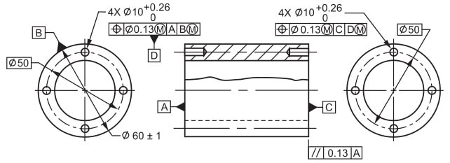

seasonlee - the first image is a problem because the datum feature D is not defined relative to datum feature C so the virtual condition for it is also not defined for the DRF that combination is applied to.
Even if that were not the case, it is entirely possible for the pairs of holes are perfectly coaxial and the part fails the position requirement because of acceptable angularity (controlled by parallelism) from one face to the other.
That means the holes are exactly where you want and every other characteristic is in tolerance and it still fails inspection.
