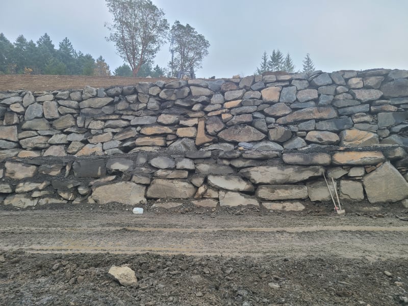

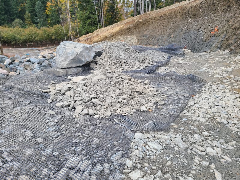

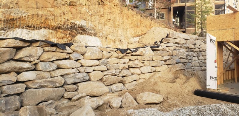

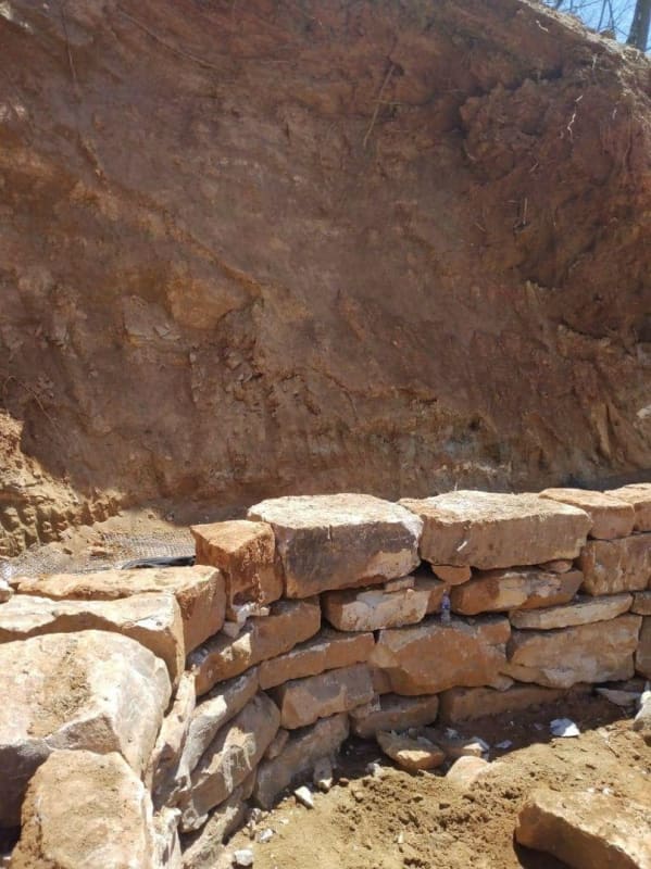

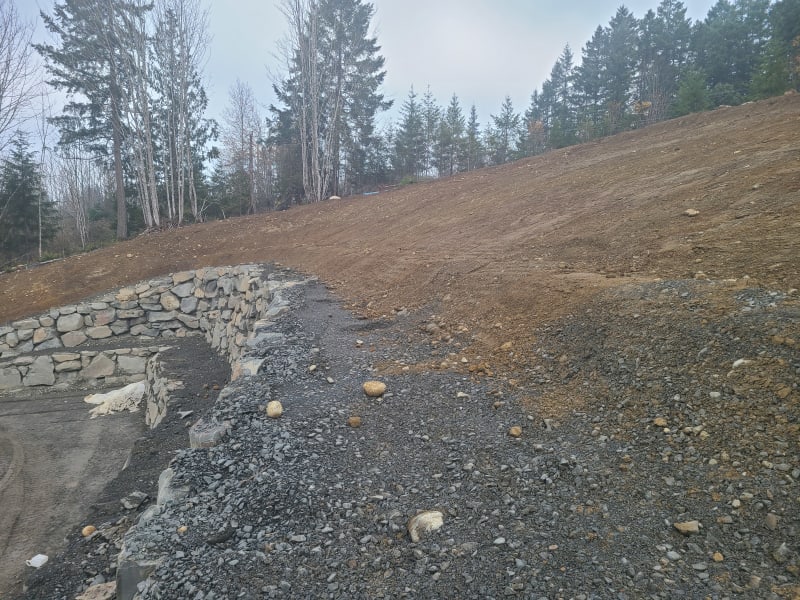

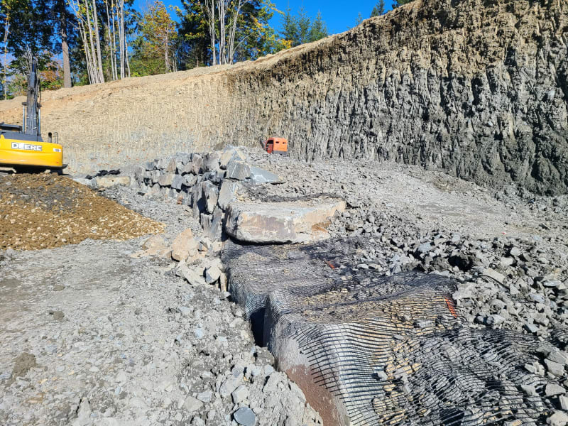

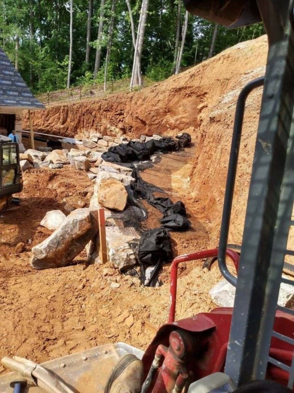

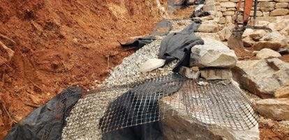

Yes, in my designs the geogrid is sandwiched between the boulders, like an SRW. I put a maximum spacing between each layer of geogrid to allow for some tolerance for different rock sizes.
Here are a few pictures. I generally see more rectangular shaped boulders for this application, like from outcropping rocks. The contractor can arrange the rocks by size to get fairly uniform lifts. Round boulders would not be a good application for this.

LOTE, your pictures are very helpful. In my area, the boulders we use are large and more rounded and achieving relatively level courses of rock is much more difficult.
