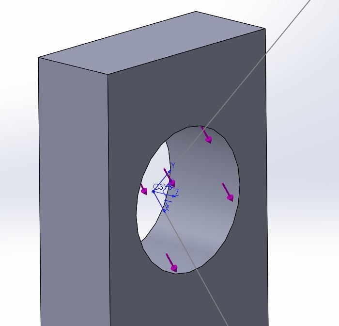

Hello,
I am trying to put a bearing load in a hole of my part for a static simulation and I have followed the steps creating a coordinate system with the z axis coaxial with the hole axis but instead of the x or y axis being the default orientation I use one of the lines from a sketch I made to orient the force at a certain angle. However every time I try to apply the bearing force it retarns the 'Bearing load requires the selection of a coordinate system and set of cylindrical faces of the same radii and the z-axis of the coordinate system must be coincident with the axis of the cylindrical faces'.
I respect these conditions so I don't know what the problem is. When I use the default x and y axis for the coordinate system the bearing load works so I thought the problem would be in my sketch but the line I give it for the x-axis is perpendicular to the z-axis so there should be no error there...
Thank you in advance!!
It should work if you put the coordinate system at the center of the hole.
It is in the center of the hole because if I don't ask the y axis to be oriented on my sketch line the function works fine. I also checked if my sketch line was in the plane perpendicular to my hole axis and everything is fine. I have tried on other holes with other sketches to test it out and always the same outcome: when I leave the y axis orientation by default it works, when I orient it with a sketch line the error pops up.
By the center of the hole, I meant the geometric center of the cylindrical surface. Like this:
So the origin should be on the midplane between the front and back face, not on the plane of the front face. Give it a try, there should be no error then.
wow it worked! thank you I have been stuck on this for a while!
