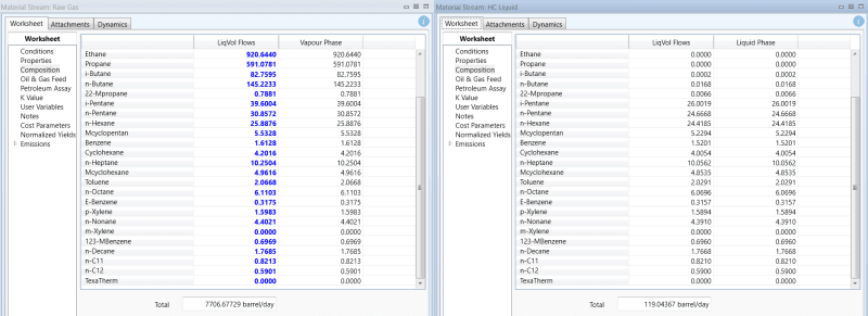

Hello, I'm new in natural gas processing and refining.
I have this problem in that I need to separate HC liquid from Raw Natural Gas fresh from the well (@ 200 degF). The gas composition has very low water composition and low heavy carbon composition, thus its dew point temperature is around 97 degF and it has 17 MMSCFD molar flow rates at 1000 psig. They expect the separated gas around 30 MMSCFD and the liquid hydrocarbon flow rate at 1200 bbl/day. (I run simulations in Hysys for the problems)
My Question:
- Is there any way to increase the dew point temperature? since I only have 1 source of well.
- How can I increase the molar flow rates, so I can reach the specified properties?
- Is there usually any initial processing for the raw gas before I perform the separating process?
- if it's possible, can someone share their learning source for the process engineering of natural gas? I was initially a drafter and learned much about separator mechanical and sizing referring to GPSA, API, ASME, and stuff but lacked processing capability.
- if it's possible, can someone also share some of your works that use Hysys simulation (flow chart is enough) for processing raw natural gas from well as an example? Because it's easier to understand if there is an example. Even though I can find it on the internet, I'm not sure if it's really done by a professional and applicable in the real process (because I believe it must be more complicated).

- The raw gas composition (by Hysys calculation) is 17 MMSCFD, but the client gave me the expected refined gas spec (after the separator) to be 30 MMSCFD. Thus I wonder if molar gas flow can be changed by physical process or not; like changing its Pressure, Velocity, Temperature, or something that affects mass flow rate? I've tried adding a cooler, compressor, and stuff but the molar gas flow is still the same.
- By the Hysys calculation from raw gas composition and its properties, the HC dew point is 97 deg F. Since the raw gas temp from the well is ~200 degF, thus it's in vapor form. I want to increase its dew point (if possible) before separating it in GAS / 3-phase separator so I can reduce the Duty of the cooler instrument (Air Cooler / Chiller). It's related to sizing and material cost.
I'm Attaching the raw gas composition, and its properties from well.

@GBTorpenhow, the initial problem is the client wants HC liquid product to be ~1300 bbl/day. since the raw natural gas is dry (I just know it's unusual, perhaps I'm going to ask the client to make sure again) I need to reduce its temperature from 200 deg F to ~15 deg F so I can achieve that production rate. But to reduce that much temperature I need a bigger Air-cooler, chiller, and/or heat exchanger. So I thought if it's possible to increase dew points then I need only to reduce the raw gas temperature from 200 deg F to let's say ~100 deg F, and by that, I perhaps only need a smaller air cooler and/or heat exchanger.
But later I found out that even if I get 1300 bbl/day of HC liquid from the 3-Phase separator, after the distillation/fractionation column, the Heavy Liquid production is still around 200 bbl/day because I suspect the raw gas composition has a small amount of Heavy HC mole composition at the first place.
and I thank you again for your concern, that's why I'm also asking for learning source material for whatever I'm lacking. Because I have no clue what I'm doing, to be honest. I'm just following the Hysys course that you need this and that and voila you get your product. But life must go on and I need to learn new things.

I think there is not 200 bbls of C-n there.

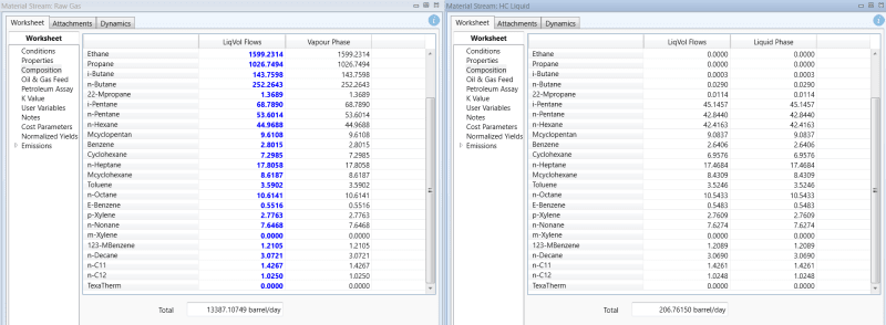

oh yeah, you're right @1503-44. Above are the Hysys calculations if I follow the gas flow rate at 17 MMSCFD. Below are the calculation of the what-if scenario when the raw gas flows at 30 MMSCFD, and it barely reaches 200 bbl/days.
Unless the specs of the equipment output they give me are designed specs and not production specs, I guess can do nothing since the product contains low liquid flow of Heavier HC in the first place.
@Lowrenstuff,
That is actually also a possibility - they gave you the design capacity (based on gas flow) and a production profile to confirm how a process designed for 30 MMSCFD would operate with the expected lower flow.
