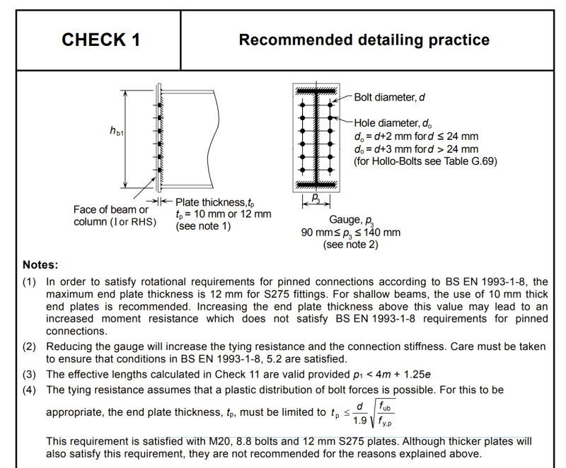

Hello,
I am reading the book SCI P358 Green book - Simple steel connections.
On page 84 - Recommended detailing practice on end plate connections, it is mentioned that the end plate should not be thicker than:
t_p < (d / 1.9) * SQRT(f_ub / f_yp)
where d is the diameter of the bolt hole, f_ub the ultimate strength of the bolt and f_yp the yield strength of the plate steel grade.
The book mentions that this condition should be fulfilled to ensure that plastic distribution of bolt forces is possible for the tying resistance of the connection.
Would anybody have some source or explanation where this condition comes from? I cannot see any intuitive interpretation of the formula, and I would like to have some intuition on what does the fulfilment of this condition mean, and what are the implications if the condition is not fulfilled.

I believe rb1957 is correct. This is a flexible end plate and not a moment connection.

I'm not sure where the formula comes from, but this is for a pinned connection following Eurocode recommendations to ensure that the connection will have adequate flexibility to behave approximately like a pin. AISC also has thickness restrictions for simple shear end plate connections. In fact, table 10-4 (of the latest steel construction manual) only lists end plates up to 3/8" thick.
Looks like some others beat me to the punch. I agree that the limit in step (4) for plastic force distribution is trying to ensure that all bolts are loaded in shear and that part doesn't necessarily have to do with the connection flexibility.

For shear connection, the AISC Manual Part 9 has a section on rotational ductility. In the 16th ed. Manual, Equation 9-52 gives the minimum bolt diameter for a given thickness. This equation could be rearranged to get the maximum plate thickness. The idea of this equation is to ensure the plate can bend out of plane to relieve bending moments that would otherwise develop
