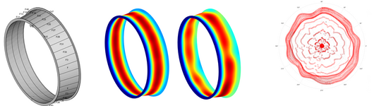

hello guys, im recently study the non-uniform temperature distribution and deformation in aero-engines(turbojet turbofan turboshaft), and the un-uniform deformation is a typical problem remains unsloved, but I cant find any material to learn from(for example, OTDF is a factor to define the temperature distribution of the combustion chamber outlet):unsure:. so is anybody knows how to deal with this kind of problems? maybe we can discuss it?
i suspect this info is proprietary to the engine manufacturers
Maybe some useful info in AIAA or SAE or documents/reports/standards...

YES Taylor. i've search those website, not much useful information.
Have you answered your own question ?
I'd've thought that engines were very susceptible to even small loads, but if this is a thing that OEMs don't worry about, then why you ?
I'd've thought (like SWC) that OEMs did worry about this, and do so in a proprietary manner, so you may not find open sources on this.
I'd've thought that OEMs worried extensively about thermal effects (the the impact of these effects on the small clearances inside the engine.
Now maybe the combustion chambers massively overrule other thermal effects (like temperature rise due to compression).
Maybe you can explain your problem some more ... "the non-uniform temperature distribution and deformation in aero-engines". Are you looking at the engine shaft specifically ? A multi-shaft engine ??.
In my ignorance I'd expect that the combustion chambers are the biggest heat source, and the engine gradually heat soaks as it runs for several hours.
But outside air is at something like -30degC, so there's a bunch of thermal modelling going on.
So by "non-uniform temperature", do you mean some of the shaft is feeling the combustion chamber temp and some other parts are feeling the outside air ?

Thank u RB1957. im now mainly foucs on turbine casing deformation.
Because the shaft of an aero-engine counteracts all kinds of non-uniform deformations due to centrifugal force during rotation, its non-uniform deformations are basically not considered.
as for turbine casing. I want to know the main reason,I would like to know the main factors that lead to its non-uniform deformation, and hopefully, Build a model that describes it(how to add up the boundary condition during CFD or FEM)
now i know a few fators(ACC, three-dimensional construction--load-bearing casing of turbine, non-uniform temp of gas, axial force of main flow,etc)
after this, maybe i will start design the structure of turbine casing making it stay uniform during the whole engine working process.
and the pic shows the non-uniform deformation of a simple turbine casing under cruise state.

  • Tip clearance control systems: using active clearance control with cooling air to shrink or expand the casing dynamically.
  • Thermal barrier coatings (TBCs) to equalize surface temperatures.
THANKS U FOR THIS INFOMATION. great help, but it looks like answer for AI.
to realize how sensitive this information is i just point you to the fact that only one of listed by me companies is using ACC (active clearace control) system in their engines and this company is finding this system as a factor giving them significant edge over competition
yes i guess this company is GE? because thier CFM56 series have ACC? DO U WORK FOR THEM jaceb? looks like u are an expert, can u give me more infomation pls:geek:
I will throw my two cents in here.
Being naive the engine has a start up
Up procedure for the engine.
The issue is there thick and thin sections.
The thin section heat up faster. Than the thin sections causing un uninformed thermal expansion. So must mitigate distortion,
Which causes emence stress.
Which causes to propagate cracks.
Due to balancing issues, close tolerance on the rotating shafts, bearings. I been researching maintenance issues.
Making sure the rotating assemblies do and must not exceed thermal temperatures.
Monitoring Temps at these assemblies.
As every one has posted, these are built into
The design. As long as the thermal properties are maintained. Air flow, lubrication and what not.
I had the honor to be part of the projects
With hot sections that utilize high temperture
Exotic alloys , inconel 718, inconel 625, waspalloy,
yes Your analysis is correct. thank u mfgenggear, what if i dont use alloys in those part?? like Composites(CMC SWC,ETC) HAVE U considered it?
