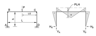

The sketch above was in one of the presentations I saw, but they only showed 1 column as being a load path. The other 3 did not depict anything. Symmetry tells us all 4 columns get the same 25% of the load. The presentation acted as if the full gravity load went down 1 column only. And coupled with the reference to LPs as the singular context, could get confusing to someone learning them. All they needed to say was that all 4 columns got 25% of applied load due to symmetry. I think they showed the load as "P" and then showed "P" going down one column.
Your fixed base rigid frame shows how much harder LPs and Reactions get to visualize when the frames are a little more complex UNLESS you include deformations in your thinking. The sketch below is the same as yours, but it is pin-based. The trickier part is explaining to someone learning how the 2 horizontal forces show up when the applied loads have no horizontal components. While the vertical reactions are simple to explain, the horizontal takes more words and visualizing the deformation that is occurring.
It also catches them off guard if you say you designed the "leanest foundations you could " for a 36' tall rigid frame building that were already poured when the Owner changed it to a 12' tall building using the same size components and did not tell you. After all, if the foundations worked for 36' tall, it makes sense they will work for 12' tall. No brainer they think. Then you have to explain in layman's terms why the foundations may not work, and you need to confirm they are still good.
