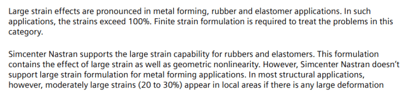

I found this paragraph in the documentation for the 106 solver (Simcenter Nastran Basic Nonlinear Analysis User's Guide basic_nonlinear.pdf section 1.1 Overview of Nonlinear Analysis and almost the same statement repeated at 3.7 Understanding Geometric Nonlinearity). This solver calculates elements in small displacements for all cases except for hyperelastic calculations (but hyperelastic calculation work only wits SOLID, Axisymmetric and Plane Strain elements and not Plane tress elements=PLATE elements). So the solver considers the change in thickness of PLATE elements to be zero. It also clearly states that this solver is not suitable for metal forming calculations.
So if your solution is within the limits of small strain then use the sdm919 solution .
If you need large strains like metal forming, then the 106 solver will give a wrong solution.
