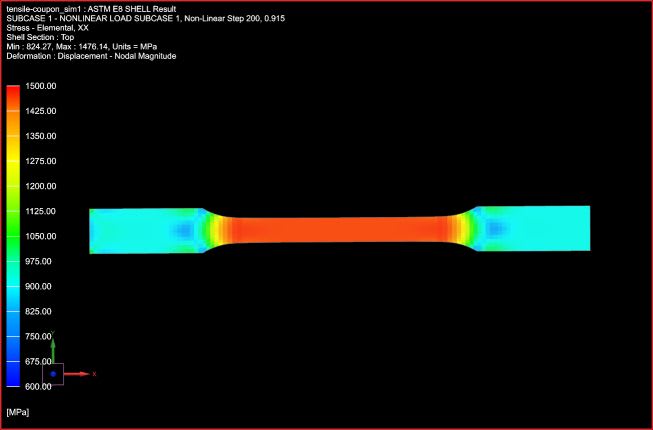

I have tried to simulate a tensile test of a dogbone specimen using SOL 106 in order to check my grasp of nonlinear simulation which I am still learning. Based on my results, I seem to be falling short in my understanding. The model consists of CQUAD4 shell elements, with one end of the specimen fully fixed and the other end subjected to a force only in the DOF 1 direction (aligned with the length of the specimen). I have LGDISP turned on. The material is defined by the stress-strain curve on the right side of the image below. The results of one of the elements with the highest stresses are shown as a stress-strain plot on the left side of the image. I was expecting the 2 curves to look similar, but the results from my simulation show 3 straight lines and not the same shape of the curve defined in the material. As well, the initial slope clearly doesn't match.
What could it be that I haven't taken into account (either in my understanding or in the simulation setup)?
Thanks,
Jeff

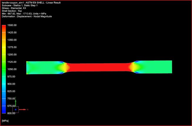

I ran SOL 101 and looking at the stress & strain contours, as well as the displacement looks ok to me. Since it is a linear analysis, I can't look at the stress or strain state across iterations like I do with the SOL 106. Below are contour plots from each simulation.
Linear:
Nonlinear:

Hmmm, ok, the stress plots look ok.
Presumably you are plotting results from an element in the center of the gage section away from the radii. The nonlinear results should track the input stress-strain curve.
The only thing I can think of is some sort of load step convergence issue.

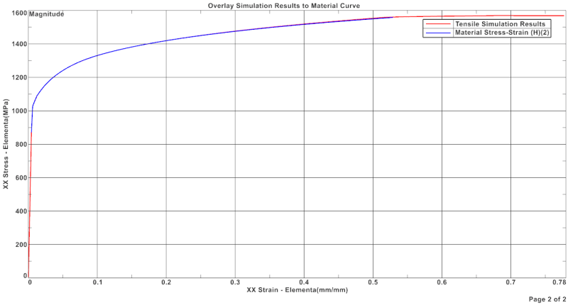

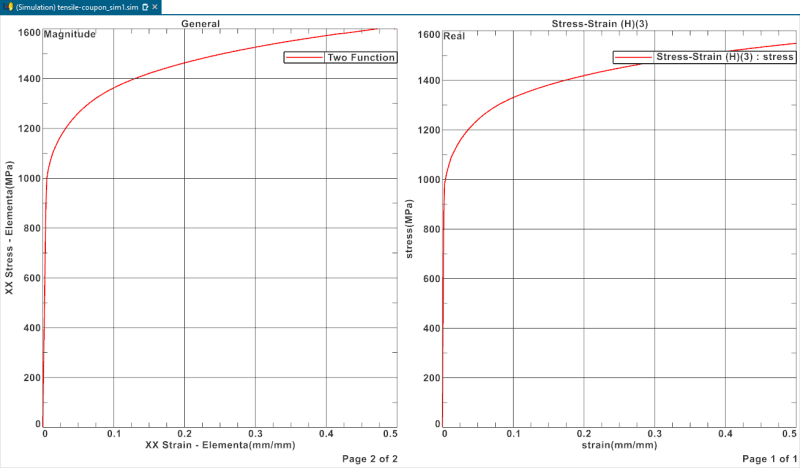

I'm definitely getting somewhere now. Thanks to your suggestions, I split the load into subcases and made sure I was getting output throughout.
Here are my comparison plots:

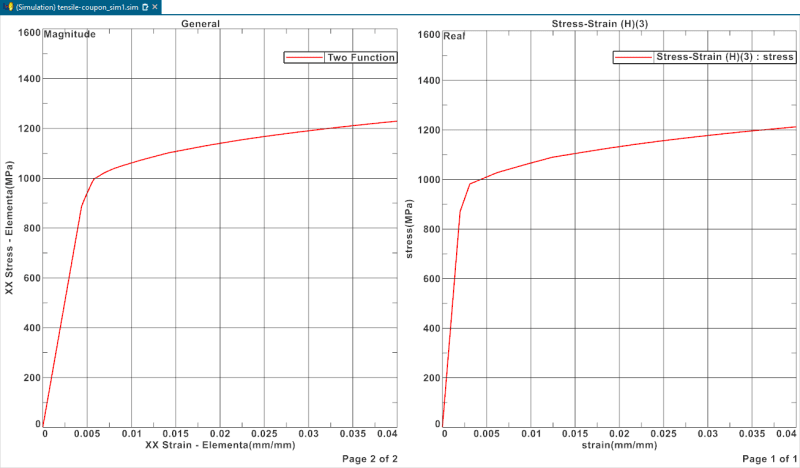

I still see some discrepancy in the initial slope (and the result near the end of the simulation). Here are plots zoomed into 0.04 strain. Any suggestions as to what is the missing piece of the puzzle?

The slope on the left (your results I guess) seems to be about 200,000 Mpa. The slope on the right (your input stress-strain curve I guess) seems to be about 480,000 Mpa. Which one is right? 200,000 Mpa seems about right for steel. Don't know what 480,000 Mpa would be.
In the plot on the right, exactly what types of stress and strain are being plotted? Are you sure that is a uniaxial tension stress-strain curve?
Just something else to check: did you try running it nonlinear material, but small displacements? (LGDISP turned off). As long as you have a nonlinear material defined, SOL 106 will consider the nonlinear material effects. LGDISP controls whether large or small displacements are considered, it has nothing to do with the material model.

Good eye! I went back and looked at the material data I had entered for MATS1 and there was some typos in the first couple of points.
I corrected the data and re-ran the simulation, (and I learned how to overlay my results on the same graph) and now everything looks good!
