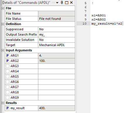

This is just an example. I created a simple model of a brick, defined as WxHxL (P1xP2xP3) in SpaceClaim to be sure how to handle different parameters into APDL code.
Inputs parameter of APDL code is ARG1, ARG2,...,ARG9. You may see it in Mechanical in the Details of "Commands (APDL)". In APDL commands you just write x1=ARG1, x2=ARG2, etc.
The output parameter(s) of APDL is given by Output Search Prefix in the same Details of "Command (APDL)", my_ by default. See the picture.
Best regards
Jiri

You have to pass your thickness parameter (P28 in your case) to input parameter of APDL code. I create an example, maybe it will be more clear for you. The parameter of thickness has a dimension, you have to change it into dimensionless parameter if you want to use it in APDL code. The deflection is pass directly into APDL.
Best regards
Jiri
