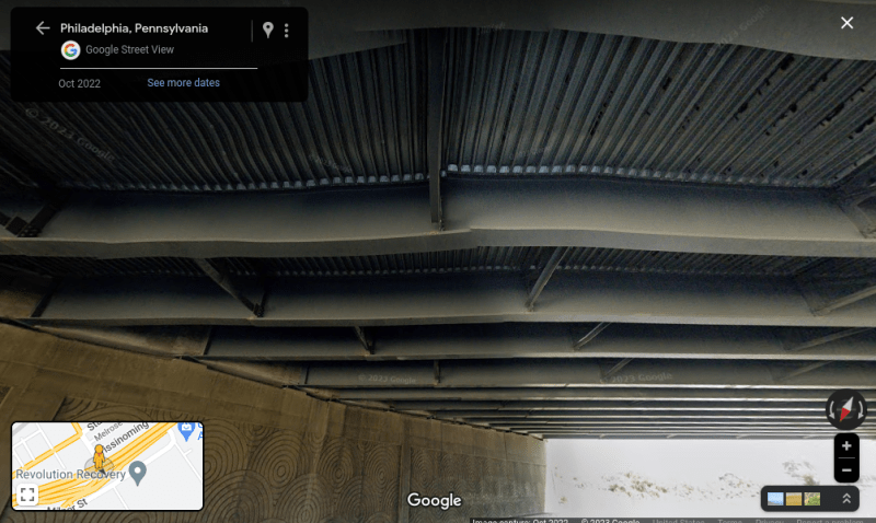

Looks like a fairly simple structure, with steel I-beams spanning between the diagonal abutments, lightweight bracing between the beams, and a poured concrete deck on top. Google Street View has pretty good imagery of the underside of the bridge:

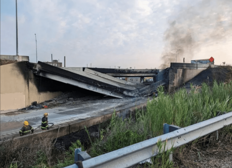

Looks like the steel softened sagged, and eventually the weight of the deck, which can not support itself with out the strength of the steel substructure, pulled one end off of the abutment. It took a very hot fire to do this in 20 minutes.

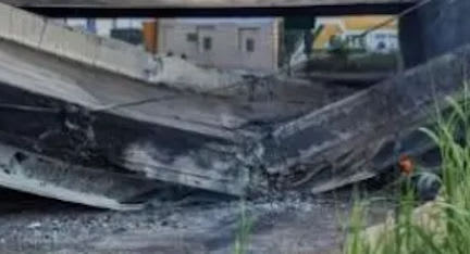

Yes, this image shows the damage and indications as to the intensity of the fire:

I have seen the results of 2 fuel tanker fires, both were fortunately on top of a bridge with the result tug reports, spalled concrete. Concrete is a really fire resistant material. Compost construction bridges do not as far as I am aware protect the steel structure with fire proofing as is commonly used in buildings to protect steel members. So direct exposure to fire will heat the steel faster and hotter.
This enlargement from a picture here clearly shows the bridge steel bent in a manner that can only happen when the steel is heated above forming temperature.
Underside of bridge showing steel.
