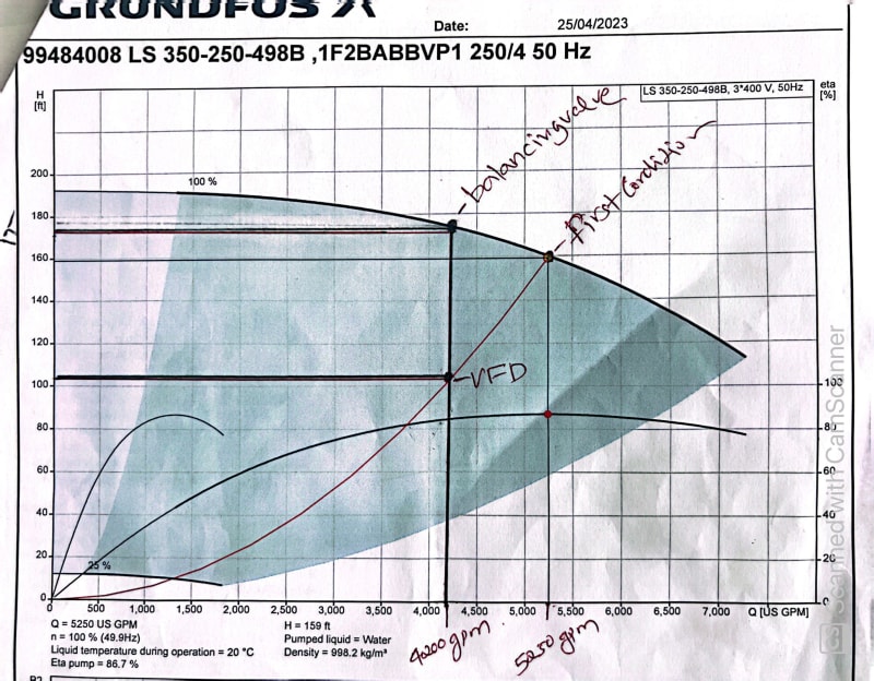

Okay, I'm going to do an experiment with a flat curve and a reduction of 20% to 40%. For experiments, I use a flat curve; the subjected secondary chilled water pump is currently powering my facility. I am corresponding the curve to the first condition, which is 5250 gpm at 159 ft/hd at 1490 rpm. The efficiency of wire-to-water is 77%. The kw is then (5250*159)/(5308*77) = 205 kw.
Planning to reduce flow rate by 20%, so it will be 4200 gpm; adjusting the balancing valve to reduce flow to 4200 gpm; increasing head to 172 ft/hd; and dropping efficiency to 2%.then the power will be 4200*172/(5308*75)=181.5kw.
with VFD of 8% drive loss, the head dropped to 101.7ft
the power will be 4200*101.7(5308*71%)=113.7 kw
the difference is=181.5-113.7=68 kw, a considerable shift, even a 20% reduction in flow

es, OK. The pump curve is flatter, so there is less gain of head when flow is reduced. A real improvement. Problem #1 solved. However now that the pump curve problem has been solved, We can see and solve the real problem with this system. The system curve is also very steep. If it gives you such a large difference in head (and power consumption) between 80 to 100% flow, the pipe diameter is definetely too small. That's a 70% something increase in power for a 20% increase in flow. IMO, that's way too high. It should be more like 40 to 50% max. The system curve should never have been designed to require so much power at any flow rate. Such high operating costs would typically be reduced with larger piping requiring less head overall. I have seen these designs used a lot in countries that have very low power costs. If power costs rise, it will not be economic to run the system at 100% flow in any case and a VFD can be a good solution to reduce power consumption at 80% flow. Many vfds have found to be of use in "fixing" what should have been a better, more optimized, design, like what happens after everyone adds their 10% fudge factors.
There should have been horsepower on that curve, which would have saved you from doing the math or making any mistakes. Because it looks to me like like at 4200 GPM that pump is still 82% efficient not 2%. It is 2% efficient at like 100 GPM.
