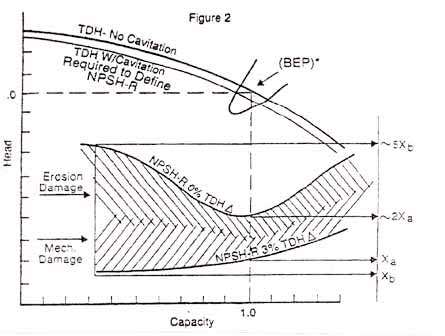

I think 1m is as said a general ROT to avoid cavitation which occurs at a higher point than the NPSH curve which is based on 3% head differential drop.
I don't know where this graph came from but they recommend 2 x the NPSH at the duty point. That would be my recommendation
