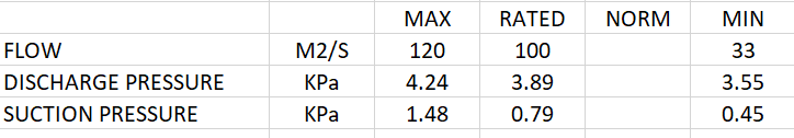

Mpa istead of Kpa to Bar was my fault .thank you. Here the exact numbers and units from datasheet. I doubt the accuracy of the vendor's use of 'Kpa'.

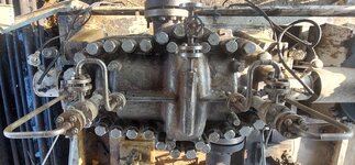

@jj - where would this pressure balance be leading out to the NDE seal ? Outside or inside the casing ?
My guess is this balance line is bunged up with calcium and magnesium salt deposits from this very brackish water, or one or more of the impellers isnt developing the head it should.
Agreed, performance curve posted here doesnt match up with stated current operation of 1barg suction, 34barg discharge at say 50m3/hr ( which converts to a diff head of about 340m)
The balance line would be external. It would connect the first stage suction to an annulus between the fourth stage suction and the non -drive end seal. Since this line is only for pressurure balance and not thrust balance, it is probably a very small line.
If this balance line plugged off, it would have little or no affect on thrust load. It would only result in increased pressure on the outboard seal, potentially resulting in premature seal failure.
My apologies for the delayed response. To clarify, there is no balance line in this system. The photo shows the entire setup. There is a drain at the bottom, but it is not visible in the image. Is it plan 31 (plan 11 with cyclone)or balance line?
Thanks. This looks like Mpa and not Kpa, but I think whoever wrote this didn't do it in stream order, which Ive seen before.
So e.g. max flow is actually associated with min discharge pressure and the reverse also true.
I think you need to look at each line independently, so min inlet pressure is still quoted as 4.5 barg, not the 1 you have.
But there is still a MASSIVE discrepancy between these numbers and the data you provide and the operating data. If the flow is really 30-40 m3/hr then the discharge pressure must be higher than the 34 barg you are quoting or something is getting confused here.
Or your pump is damaged internally, hence the vibrations. So I think the first thing you need to do is strip it down and have a good look. Or for some reason one side of the pump is blocked or restricted and you're getting non balanced flow. Maybe dirt, wax, a stone, who knows.
