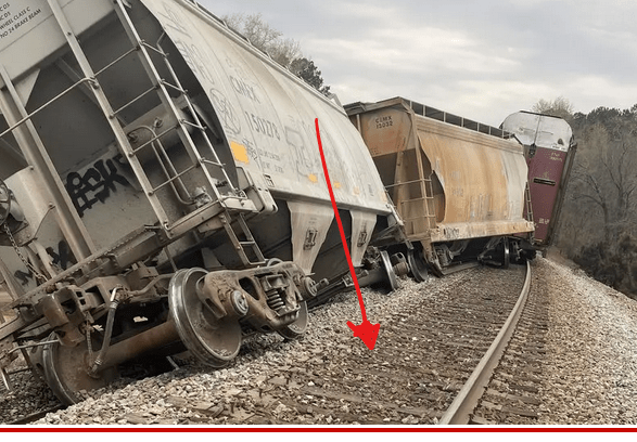

Another Norfolk Southern train has derailed, this time in Alabama:
Norfolk Southern train derails in Alabama hours before CEO grilled by Congress
This does not look good, not when the CEO is about to testify before Congress.

The report indicates that 30 cars were involved in the derailment but the claim is that none of them are leaking. They did not say that the cars weren't carrying hazardous material, just that there was no leaks.
