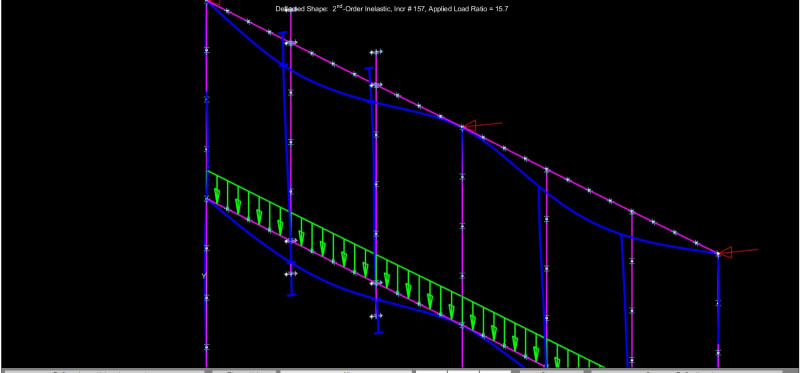

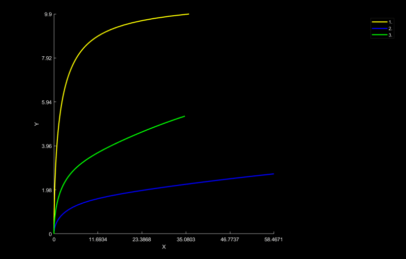

Before trying to calculate by hand, i created three Mastan models to verify the beam resistence and the models did show a considerable increase in the resistance. The models still don't include the flexibility of the connections, so i will do this next, for both the stiffened and unstiffened connections.
I Introduced partial yielding and initial imperfections as described on the stability fun guide of Mastan.
In the first model, the intermediate beam acted alone(Blue Curve), while in the second, the tie was connecting the beams by pins(Green Curve), resulting in a 96% increase that is close to the 100% increase expected and in the third model, the tie was connecting the beams by rigid connections, resulting in a 267% increase(Yellow Curve)
I'd wonder if perhaps your Mastan model is more significantly impacted by the intermediate "support" conditions provided by the hangers rather than any bracing they may provide. I could see the hangers significantly impacting the moment gradient and potentially at least in the fixed model developing full moment reversal which if I recall from the Yura paper can significantly increase Cb.
Celt, this effect is introduced on the model where i pinned the ties, or hangers (Green curve). I think that it will behave as a lean-on bracing, what is verified by the fact that the load is almost doubled.

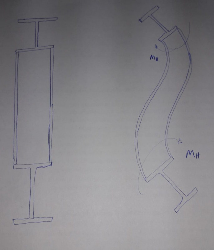

MotorCity, i think that you didn't understand how the bracing is working. The following image shows the behaviour that i'm considering. The Hanger will share the load with the top beam but if the beams fail by ltb, the hanger will bend out of plane. The hanger resists and applies a reacting moment, which a called Mh, that reduces te torsion on both beams. If the hanger is stiff enough, the will remain vertical and will displace only laterally, which occurs for a higher load. I'm not considering that the hanger braces the top chord laterally.

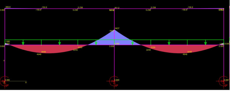

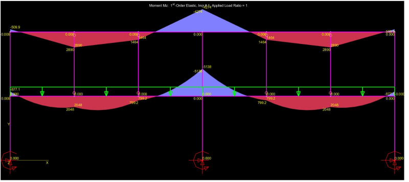

A - First i'll show the BMDs of each model for 1st order analysis and a uniform load of 1KN/m:
A.1 - When the beam is acting alone:
Mmax=9,437KN.m
Cb=2,03

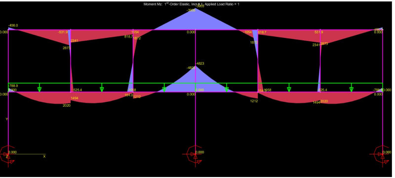

A.2 - When the beams are pin-connected to the hangers, the BMD for 1st order elastic analysis is the following:
Mmax=5,138KN.m
Cb=2,16
The maximum bending moment reduced 45,6% and Cb increased 6,4%, so the load increase 95%, consistent with the previous 2nd order inelastic analysis.
A.3 - When the beams are pin-connected to the hangers in-plane and rigid out-of-plane, the BMD is equal to A.2, so if not for some bracing effect, the failure load should be equal to A.2, but the 2nd order inelastic analysis shows a 75% increase to model A.2 (240% increase to model A.1)
A.4 - When the beams are rigidly connected to the hangers, i obtain the following BMD:
Mmax=4,823KN.m
Cb=2,16
The 2nd order inelastic analysis show 6,5% increase to model 3, consistent with the 1st order analyis. This small increase occurs because the hangers absorb a share of the bending moment of the beams.
B - The deflected shape that i obtain with the 2nd order inelastic analysis show the beams almost vertical at the intersection with the hangers, which confirms that these act as torsional bracing

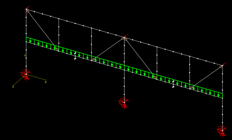

PhamENG, because of your comment on the Vierendeel truss, i had an insight and decided to change the concept. I talked to the contractor about the possibility of putting some HSS diagonals like shown below and he said that could bulid the masonry this way. So i decided to change to this truss configuration.
In this new configuration, i substitued the W-Shapes for HSS shapes with strong axis horizontal. Both are subjected primarily to axial load, while the bottom one to flexure-tension, but the bending is continuous with support at each 1/3 span, so values much below the former solution.

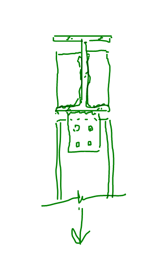

Yes, that's an excellent bracing system and you're pretty much nailed the concept. I'm afraid that you've been led astray pretty badly in many of the previous posts that question your approach here.
Italo01 said:
I don't think that it won't be as effective as a traditional bracing where the beams are on the same horizontal plane but may be sufficiente.
Toss in some dirt simple stiffener detailing, as 271828 suggested, and I feel that your system would be as effective as when the beams are in the same horizontal plane.

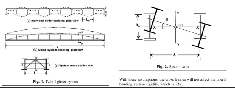

Your system bears great similarity to how diaphragm bracing is used for twin bridge girder buckling, per the sketch below. And I'd be tempted to adapt similar checking procedures. That, combined with your MASTAN work, would give me great confidence in this system.
Moreover, pretty much ever truss chord the world over is torsionally braced by its webs in exactly the same way.

Don't do that. It's unnecessary if the beams are already designed properly and it will make the wall more difficult to construct. You had the right idea straight out of the gate.
As far as your stiffener detailing goes, it can be as easy as the sketch shown below.

i was very confident about my approach and is good to see someone so experient and knowledgeable as you to confirm it. With respect to the second approach, i changed it not because i didn't feel confident about the first approach but because i could reduce considerably the weight of the steel, since the moments are much smaller and the stiffness is much greater.
I know that its going to be more difficult to construct the wall and maybe you'd think that its not worth it to the client the cost offset but i assure you that in my region it is. I live in Brazil where the cost of Steel is twice the cost in usa and where labor cost is 1/5th ot the usa.
