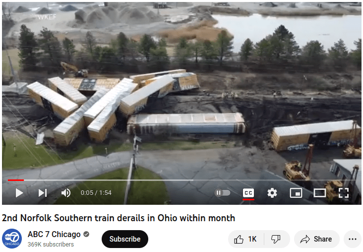

Another Train Crash in Ohio
"out of an abundance of caution”

Link to more video
RAW: Drone footage shows train derailment in Springfield
Officials Give Train Derailment Update WLWT Not really anything new, relatively routine cleanup.
Well that certainly doesn't look very good at all

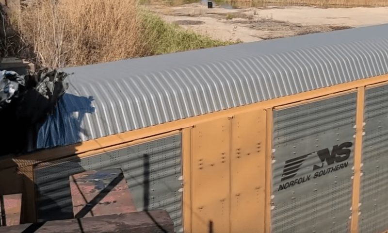

And did you notice the name on the train car:
John R. Baker, P.E. (ret)
Irvine, CA

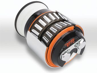

Timken used to supply the barrel steel for Roy Weatherby's rifles... ICYC.

"And did you notice the name on the train car"
I'm shocked, I tell you SHOCKED, to find that this glorious event actually happened on Norfolk Southern tracks at Memphis on September 6, 2020.
