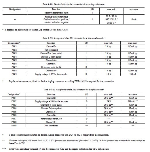

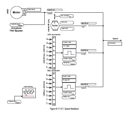

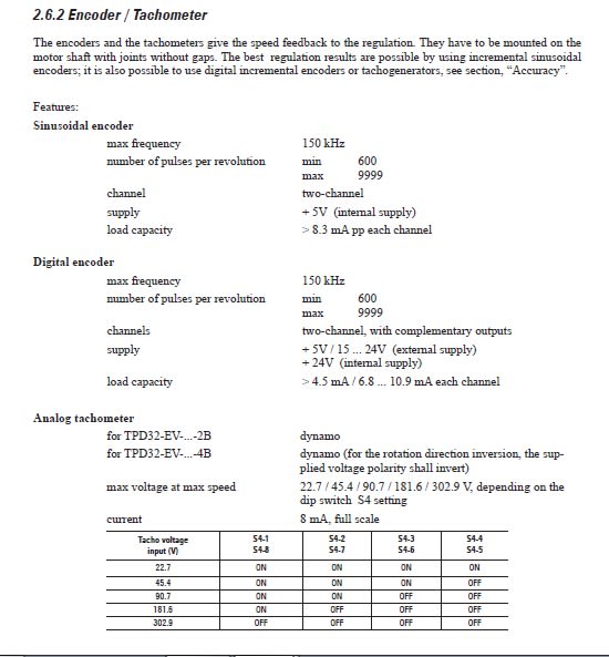

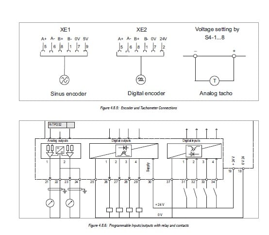

Speed feedback terminals
lukin1977
Jan 19, 2009
397
PY
Does anyone knows what are the terminals A B C (between - and +) for?
Picture is of a DC Drive. - and + are used to connect a tachogenerator coupled to the motor.
Conector ENC 1 is for sinusoidal enconder
Conector ENC 2 is for digital enconder
I have looked in the manual but could not find it
thanks
Just a WAG;
Will the drive accept a selsyn input as an option or would a selsyn be the sinusoidal input?
Ohm's law
Not just a good idea;
It's the LAW!
Apparently not. Here are some images from the manual. It never says anything about those 3 terminals
It's kind of listed in the 2nd page of your image except they've added polarity.
