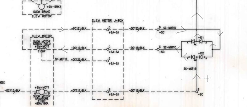

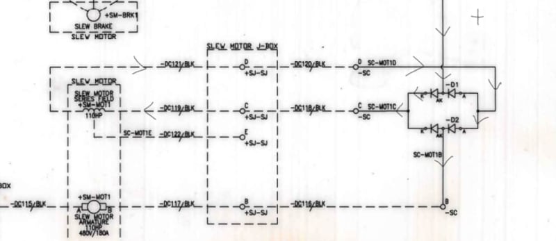

Interchanging A1&B2 will not work in cumulative compound motor. Either you need the 4 way contactor/connector as shown or you need diode control as below.
Forward
Reverse
I have converted such 4 way contactors to diode control with no moving parts for offshore oil rigs cranes.
