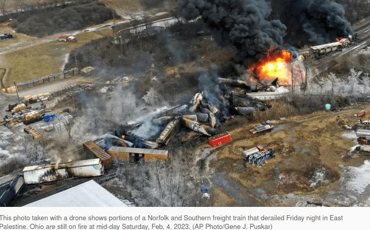

This derailment includes a bunch of tank cars. It will take several days to clear the scrap before rebuilding of the railway is can start, this location has relatively good access, so recovery equipment does not need to travel only by rail.

Here's a source for a daylight aerial:
I also see that there's a track switch right "under" the wreck (feeding the industrial building below the tracks). That might be the location of the problem.
They move the scrap off of the roadway, and then start track repair/replacement. The (former) freight cars usually sit to the side for awhile, as there's then no rush.
I expect crews and equipment are starting to show up already, waiting for the fire to be extinguished. I believe the track will be operational within a week.

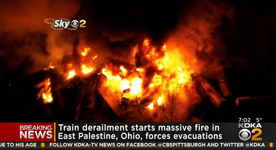

"Residents near the site of a train derailment that sparked a massive fire in East Palestine, Ohio, were urged to evacuate immediately Sunday night due to the risk of an explosion, authorities said.
“Within the last two hours, a drastic temperature change has taken place in a rail car, and there is now the potential of a catastrophic tanker failure which could cause an explosion with the potential of deadly shrapnel traveling up to a mile,” Gov. Mike DeWine warned in a statement Sunday."

A temperature rise in the vinyl chloride tanks (or butyl acrylate) is suggestive of potential self accelerating polymerization. Very bad for a closed container, and probably why they're threatening to arrest anyone remaining inside the evacuation zone.
50 cars derailed. They are expecting explosions.
Single digits Fahrenheit isnt particularly cold in the grand scale of automotive/rail testing. Lab testing typically runs to -20F or -30F with additional site-testing done in the Yukon or Alaska at lower temps. I'd have my doubts that eastern Ohio reached single-digit temps but even if they did it shouldn't cause critical failures.
I suspect the fires are intentionally being allowed to burn under the guise of safety but also as a means of limiting the necessary cleanup. Not only is surface spread an issue with liquids but also ground soak, so while extinguishing and recapture of contaminants seems ideal a big raging fire to cook it all into the atmosphere is sometimes preferrable.
