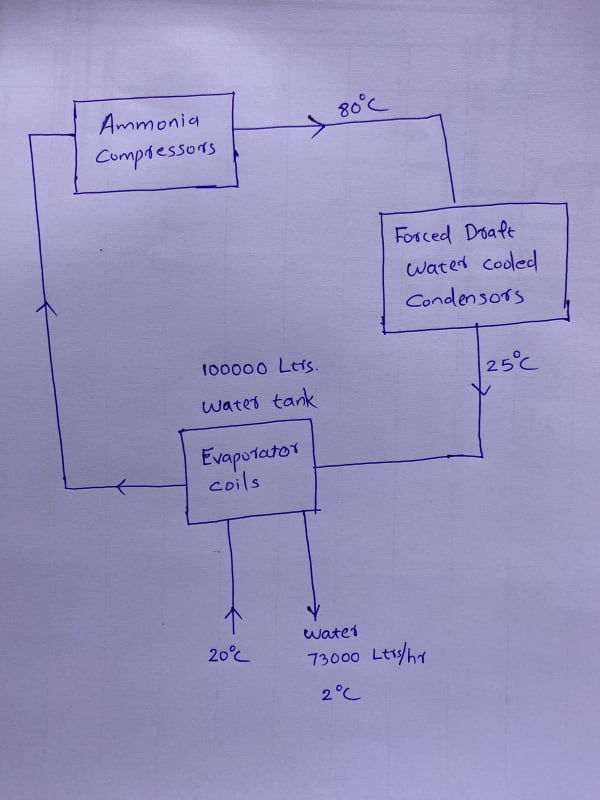

What would be the total KWH poeer of my ammonia compressors?
Zainu
Agricultural
Jan 15, 2023
8
BH
Our IBT (like chilled water tank) has capacity of 1 lakh liters of water, the forward chilled water flow rate is 73000ltrs/ hr, the forward and return temperatures of chilled water are 2dc and 20dc, the load time can be considered as 24 hrs and all compressors are ammonia operated having superheated ammonia temperature of 80dc. The condensors are forced draft type and condensed ammonia temperature is 25dc. Then what would be the total KWH of my compressors?
Should we consider the capacity of water cooled condensors while calculating the power rate required for the above?

OP, you should show some sort of drawing. Your narrative description is confusing, at best. I have to assume lakh refers to 100,000, for example. You say "compressors are ammonia operated" and then "condensed ammonia temperature is 25dc" which seems contradictory. Ignoring that, your water flow's change in temperature would give you the change in energy.
TTFN (ta ta for now)
Draw a diagram of your cycle/process, draw a box around it, and perform an energy balance for all the mass/energy flows entering and leaving the box.
power is a rate, by the way.
You have 2 changes in temperature, for which you can calculate two changes in energy. You've only given enough information to barely calculate the one with water.
Diagram is missing a JT device in between the condenser and evaporator. What are your condenser and evaporator pressures?
Tell us what type of compressor : 2stage reciprocating I suspect.
Why are you turning to E-tips for this info? There are folks who can help with this laborious calc but we normally only provide tips. Show us your solution workup. Or have you lost hope getting a solution ?

The simplified diagram is one which I posted earlier.

As i read your diagram you not only supply the chilled water with NH3 from these compressors - but also a lot of other systems. So you couldnt calculate your compressor power just from the tanks.
So, unless your NH3 pressure is much lower than intended then i think that the problem must be on the heat transfer side in the tanks - not the avaiable compressor power. My guess is that you simply dont get enough NH3 through the cooling coils in the tank (i.e. the coils are too small).

Nice schematic, but doesn't tell you much or where you can measure flow, temperature or pressure.
You appear to have 2 x 110kW, 1 x 90 and 2 x 55kW compressors in the main cooling cycle. Just measure power consumption from the running compressors will tell you what energy you're consuming.

Presume the problem is with not getting the exit chilled water down to 1-2degC ?
Looking at your schematic, it seems the problem may be in IBT 1A/1B (as @MortenA has indicated). Getting water down this close to freeze point is not possible unless you have very high heat transfer coeff and no dead ends on the water side. These are plain coils immersed in water which is agitated but external htc may not be high enough to prevent icing on the water side. Hence the ice acts as a large resistance to heat transfer to the cold subzero ammonia evaporating on the tube side, which is floating on the HP stage NH3 compressors.
Can think of 2 possible solutions:
A)Use a pumped scheme for chilling at IBT 1A/1B with a welded plate HX in order to get high heat transfer with no dead ends. Where water is taken from a warmer part of this tank and returned to a cooler side of the tank. Recirculation rate to be kept constant with dedicated recirc. pump to maintain high heat transfer coeff on the water side. Remove the current chilling coils in this tank.
B)Replace the entire chilled water circuit with a propylene glycol water mix which has a lower freeze point. For example, for a 30% wt prop glycol water mix, freeze point is -14degC, while that for 20% solution, it is -8degC. Possible disadvantage of this scheme is the lower heat transfer characteristics of prop glycol/water mix, which will mean higher circulation rates, and more heat transfer area to compensate.
I would tend to go for solution A due to the thermal duty risks throughout the entire plant associated with solution B. With this solution, also see if you can raise the temp of evaporating NH3 by introducing a backpressure control valve on the discharge of the NH3 accumulators on this IBT 1A/B - this would enable less risk of water ice on the chilled water side of the plate HX. Ask the plate HX designer to give you a worst case estimate for the surface/film temp at the cold end of this HX, and if necessary, maybe change out to a 10-15% wt prop glycol - water mix to give you a little more room if you must have chilled water at 2degC. Running the plate HX in co current mode rather than the conventional full countercurrent mode will also help to prevent icing on the chilled water side.
By comparing the value for ((cp.mu)^0.14).(k^0.86) for water and 20% wt PPG/water at a mean 13degC, I see there is only a 5% reduction in heat transfer "effectiveness", so it should be possible to use 20% wt PPG/water instead of plain water. Which would you much more room to allow an operable design for the new plate HX.
