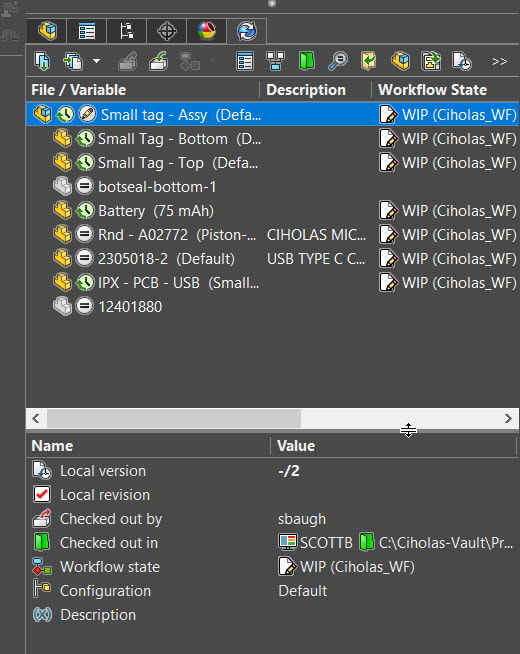

Hrm... we'll I've never used the task pane before but on your instruction I tried and do not see the same options, unfortunately.
The assembly (not checked out):
The drawing (checked out):
Is there some sort of interconnectivity that is not enabled?

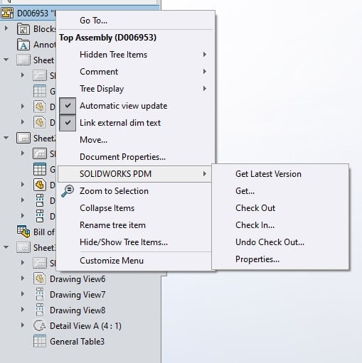

Can you right click on it in the file tree to check it out from there?
Which version of solidworks?
Are there other windows available on the task pane? I see others in addition to the info box.
Ah, that may be the ticket Matt.
Never saw this context menu before:
I will try that next time it comes up.

Yep, exactly what I was suggesting.

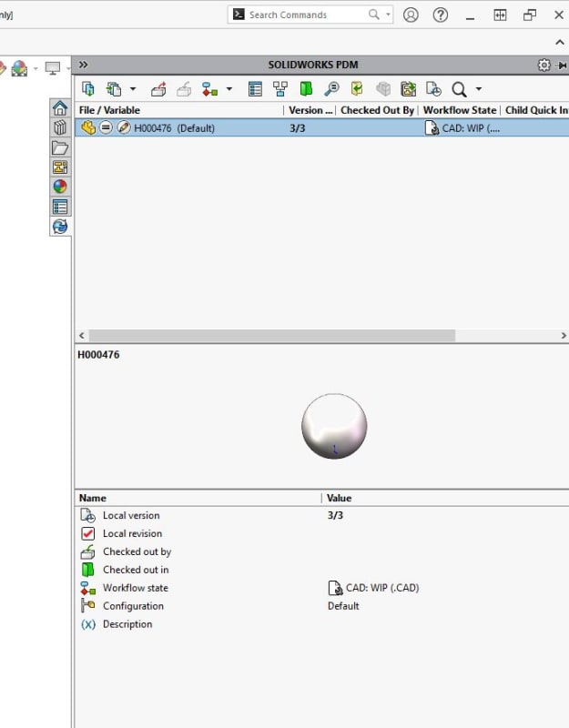

As far as the task pane, that's the toolbar options that are typically over on the right. I'll try to attach a screenshot.

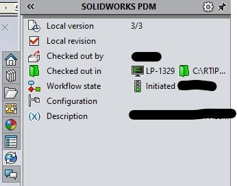

Normally there would be more options/windows there than what you have shown in your screenshot. Perhaps the other boxes are there and just need expanded.
I was in the middle of dismissing your suggestion because I couldn't find anything to "expand" but it turns out that there is a fine gray bar at the top that I can drag down to see the other information you are showing!
This is very strange to me because I did not make any settings changes myself that would have caused this. Now that I can see this information I also have the check-in/out buttons and such right there!
[banghead] So silly.
