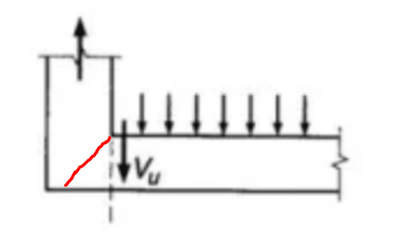

I’m still kind of confused. Say it was connected to a girder, would there still be a compressive force. I attached a picture from the code, and wouldn’t this case be similar to a RCC cantilever beam?
 https://files.engineering.com/getfile.aspx?folder=7d6ea7c1-a418-45a0-a559-cb6ee941d6ab&file=02457414-DCA8-4C96-BE59-E14E176DDF7D.jpeg
The example you attached has tension at the support, not the required compression, so the critical section is at the face of the support.

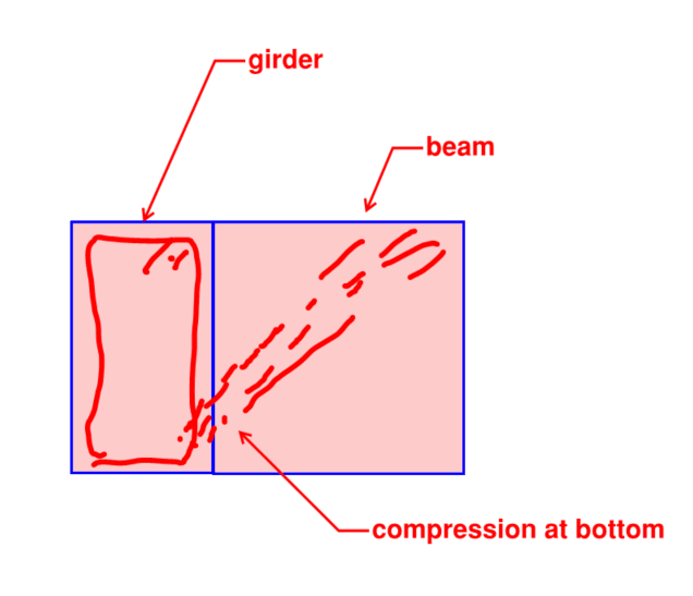

If the beam frames into the side of a girder of equal depth, there would not be compression in the end region in the direction of the applied shear since it is not supported at its bottom.

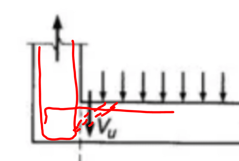

I disagree per the sketch below. The intent of hanger steel in the girder is precisely to provide a path for that last compression strut at the end of the beam.
Interestingly, one could make the same argument for the hanging situation so long as the hangers are detailed properly. Obviously, the code says what it says and we're not going to go rogue on that unless there's a compelling reason to do so.
Taking the shear right to the face of the support only really makes sense to me when considering a hanger support that has no properly designed hanger bars. In that case, we'd be anticipating the shear crack shown below. But, then, who would be foolish enough to do that?

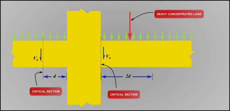

This blog has some useful diagrams regarding the correct location for critical shear section:
In particular this diagram is a good summary:
Note too that this is this critical section for shear. Critical sections for bending are at different locations.
