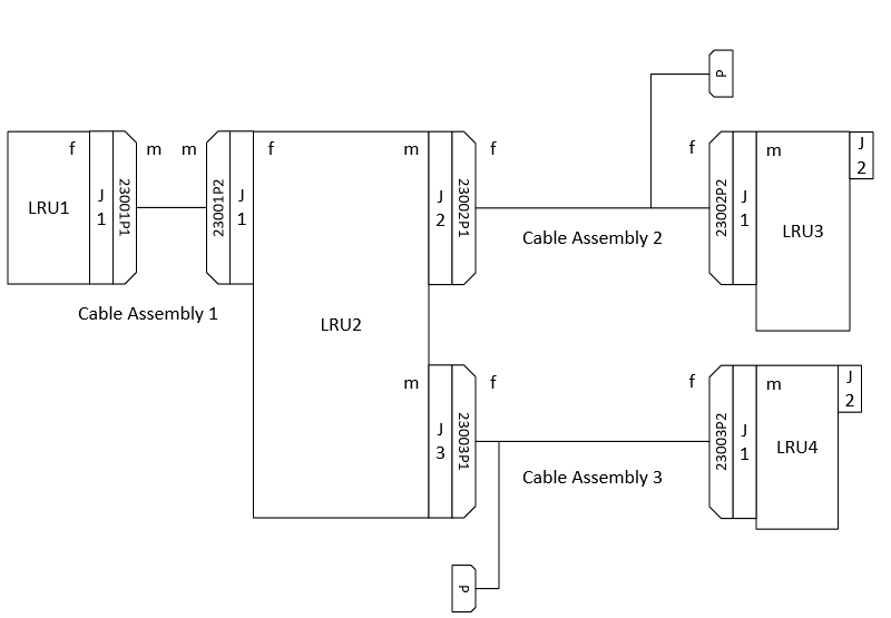

Generally I try to stick with the following convention (see pic):
[ol 1]
[li]LRU connectors have sequential Jn assignments regardless of what gender the pins or whether the manufacturer calls it receptacle or plug.[/li]
[li]All that plugs into the LRU Js are then Ps (loose ends). Also regardless of gender.[/li]
[/ol]
Now with that out of the way how would you go about numbering the mating connectors in the system wiring harness that may comprise several individual cable assys, some ends may have interfaces to the aircraft (meaning in a wiring diagram issued to an installer before they will likely get re-named by them iaw. their own conventions).[/li]
Would you start each cable assembly having its connectors named P1, P2, P3 regardless of where they plug into?
In other words a P1 could plug into a J2 - making some people uncomfortable.
One could also number them (regardless of what assy they belong to) sequentially that there will never be two P1s also causing non-matching numbers to mate.
Also there could be two P1s in the overall system harness but in different cable assys, that will also make some people unhappy.
But from my POV however having each cable assy numbered P1 to Pn is the most logical in a presentation, regardless of which LRU J they plug into.
Any comments? Thanks, Mike

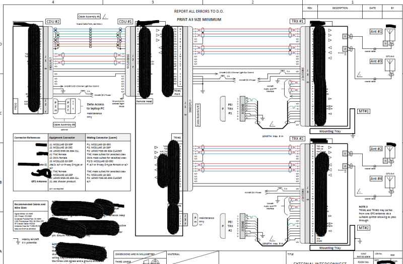

Example small system intentionally showing no P numbering:

You're missing a bunch of information that might make your question moot. Give the cables harness numbers, and the connectors reference identifiers based on the ATA code of the systems you're interconnecting. With such unique identifiers in the system, you may feel less compelled to make the connectors at each end of a cable P1 and P2 because all the other prepended numbers will make the connectors unique before you do that. You'll have "24210P1" and "24211P1" which are already unique.

Using your example I assume 24210P1 would be 4-digit ATA code, one digit harness ID then Connector ID?
So I use the ATA code within our system interconnect as well and not just for the interface between our system and the aircraft's e.g. audio and power systems?
Also we have no control over what that interface between our system and their system will physically look like, it is not up to us to define this. Therefore it is probably even pointless to give that a connector or 2300 number at all.
Mike
Is the below roughly what you propose?

Your updated diagram is a bit closer to the typical presentation of OEM wiring diagrams, with a few quirks and several large gaps yet to be filled. This diagram only works if the cable harness is already completely fashioned end to end for plug-n-play installation. That's terribly rare. You usually have to pass your harness through some other disconnects for it to fit the aircraft. There are no intermediate disconnects in your diagram. That's a hint you are far away from "prime time" and the solution to this is to go see the aircraft and read its books. Take copies, download PDF's or whatever, and determine how your wiring will integrate into the rest of the aircraft.
Do you have a pin-out definition somewhere? Usually the majority of the time to do the layout consists of drawing all the wires. Having it on a separate harness diagram works, too, but makes troubleshooting harder.
As another point of reference, your work so far looks like "10%" of the job done. Just sayin'.

Thanks for the contributions so far. I think there is still some confusion as to what I am after.
We are providing small systems that will be integrated primarily in helicopters (medium to large) and aircraft, special mission stuff. Generally this is retrofit but sometimes it goes into factory new aircraft. In this case a comms system. We have no control on which platform the system will get installed on, we generally know but it is out of our hands. They buy a capability i.e. black boxes from us with some docs and from thereon do their own stuff. In this case it will be many different types and their variants, can be MIL or CIV. The diagram is provided for the sole purpose that the system installer/fitter e.g. part 23 org reads, interprets and then draws up their own wiring diagram that will be specific to the platform they are working on and will conform to their applicable standards. From that POV I can supply more or less what I want (informal) as long as they can read it, it makes sense and is correct. The demands of the platform regards wiring is generally not known to us and all they want and wanted over the last 25 years was such an interconnect that shows how the boxes are to be wired between one another and what and where are the interfaces to the platform. With that of course go some other interface docs. So far they were totally content on what we had delivered in the past.
So all I wanted to know here is what is the best strategy to name the removable connectors of the harnesses that connect the LRUs; in this case this is essentially only two harnesses: one between CDU1 and 2 and the other one between CDU1 and two radios. Of course they won't care about my names as they will re-name them anyway, so the question applies only to this initially supplied drawing. Here I have implemented Sparweb's method (light grey connectors on the harness between the LRUs and added a gender m/f).
We don’t supply or build the harness either, not even the connectors.

At this point I have no idea what your question really is - all I would do is make a list of the vendor CAGE and Part Number for each box and each box connection, the mating number and a wire list to show which connectors and pins were to connected by listing box#, connector maker CAGE, connector part number, and pin numbers. The wire list will include info about twisted pairs, shielding, and correct wire gauge as required. I would expect the boxes have labels next to the connectors - this can be reference information on the connector list.
If your company isn't making the harness or designing the harness then you don't need to make a diagram of the harness.
