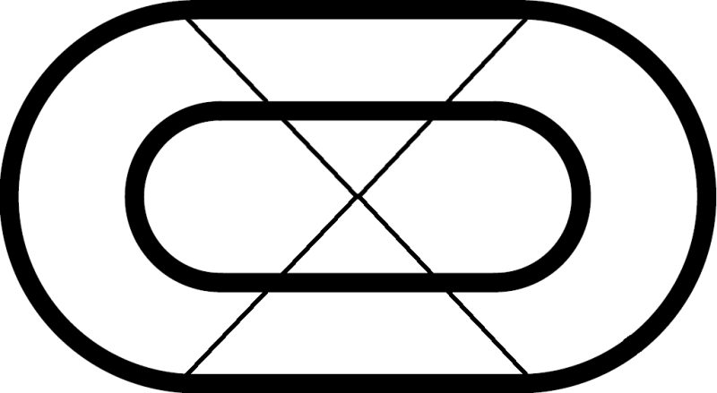

A nitpick on figure G - which is incorrect in "ON THE DRAWING." The tangents on the upper surface and bottom surface should be the same distance apart - that is the flat faces aren't trapezoidal as the diagram shows, they are tilted rectangles. Just bugs me as anyone who has done drafting should spot that a mile away.
The other choice for figure G "ON THE DRAWING" is that they aren't right-cones on the ends, in which case the gap between the inner and outer profiles won't be uniform as depicted - the side slope won't be constant around the part and will be larger at a larger distance.
Either way, the figure is borked.

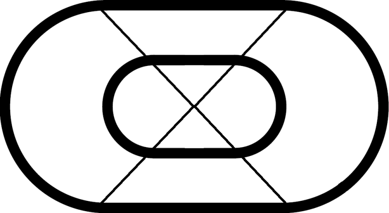

Here is the current Figure G top view extension lines from the bottom edge tangent points to the vertex:
Those lines should go through the matching tangent points on the top edge - clearly they do not.
This is correct for a single vertex solution:
