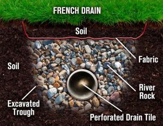

What is your definition of a French drain? Mine is a post hole sunk vertically to below the frost line, approximately 48" to 60" for the Southern half of Wisconsin and then filled with clean rock/large gravel. Maybe including a sock filter to prevent fines from invading the hole. Which they will eventually, anyway. This allows free-draining of any water that enters the hole.
On your pictures, take 4 of them with one each of the four cardinal directions, showing the 4 complete elevations. As you take each picture, turn 180 degrees and take 4 more pictures of the ground going out from the building. The one picture of the slope running down to the house is a very good start, but back up and take a picture/detail showing a larger view of the slope. Take any other pictures necessary to show local details needed to understand the drainage situation.
Label all the elevations with their cardinal directions as well as the other four pictures showing the grounds extending out in the cardinal directions.
On the side of the house with the sloped ground draining toward the house, you might locate a swale approximately 15' to 20' away from the house with a slight ditch on the high side of the swale extending in a U shaped pattern around the house on the 3 high sides. You might also install an ABS drain tube below frost line also extending in a U shaped pattern around the house. This tube will drain to daylight on both ends if possible or a French drain if draining to daylight is not possible.
There are endless variations possible depending on the local situation. Contact a local landscape architect who understands drainage for more specific help.
Jim
The French drain needs to be sized in diameter so it will hold all or most of the water that enters it.
"French Drains" for me are a trench cut down to what ever depth you like, but typically 18 inchs to 2 feet, lined with geotex type material, then loose stone / large gravel for 6 inches, then a PVC perforated pipe laid at some sort of slope angle and then back fill with loose gravel. You can even overlay the top with turf if you want.
Looks to me to be exactly what you need in that area of ground you've just cleared or even right alongside the house.
I would get some sort of fall on your pipe and then connect to a soakaway beyond the house.
