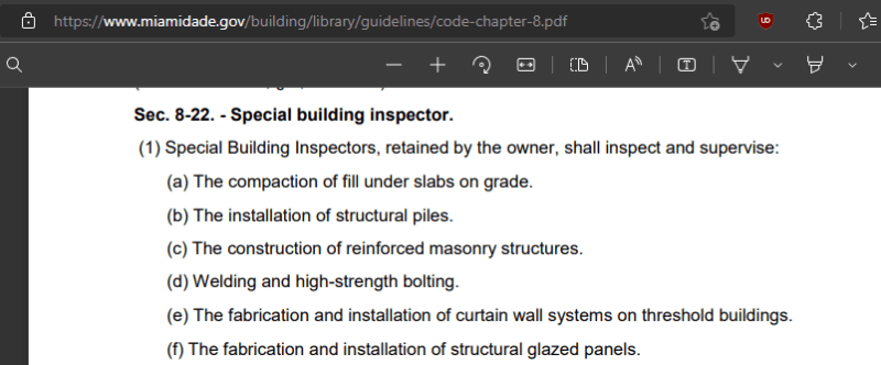

An additional question. Since my project is in Miami-Dade, I went and looked up code 8-22, which lists this:
When is says that "Special Building Inspectors... shall inspect and supervise:", and if we look specifically at high-strength bolting, where does one find the frequency and type of inspection? Is this just known knowledge in the state, or is it listed somewhere else?
Would the inspection that is done more or less correlate with the normal special inspection table?
I think you often see Special Inspectors rely on the guidance of the ICC or other trade publications for what should be done - but I don't know of a place central to the FBC which delineates those responsibilities.
I would recommend a call to Miami Dade County outlining what you propose to do and if they have any other recommendations. Also keep an eye out for the higher wind speeds in the FBC for the "High Velocity Hurricane Zone".
