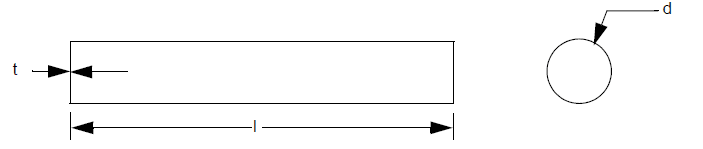

Hello,
It might sound weird but I would like to make a free-free preloaded modal analysis. Imagine that a rocket flies with its pressurized propellant tanks. I want to include the stiffening effect of the pressure. I tried two things:
1. Restrain the structure during static (preload) load step. Refer to first load step and have no SPC definition in modal analysis.
2. Do an unrestrained analysis (inertia relief). Refer to first load step and have no SPC definition in modal analysis.
In both cases, I end up with only 3 rigid modes - very close to zero. The remaining 3 modes are actually rigid modes when I visualize them, but their frequency value are way high. Can anyone think of how to approach such problem?
I am actually doing trial analysis with a representative tank structure; standard steel properties with 50 mm diameter, 0.4 mm wall thickness, 6 mm cap thicknesses, 250 mm length, internal pressure of 0.7 MPa.
Any help would be highly appreciated.
Which software are you using ? How many modes have you requested ? Can you say what kind of structure you want to analyze ?
Thanks for your reply. I am using Hypermesh as pre/postprocessor and Optistruct as solver. I requested 10 modes. I am attaching .fem file too.
It is a tank cyclindrical tank as follows: Standard steel properties with 50 mm diameter, 0.4 mm wall thickness, 6 mm cap thicknesses, 250 mm length, internal pressure of 0.7 MPa.

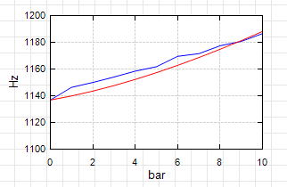

Can you get a simple structure that does solve, and try it with different inflation pressures, to check that that is a viable method?
It seems to me there are several confounding effects (1) dimensional changes due to gas pressure (2) mass loading of the skin by the gas and (c) the effect of the skin stress due to pressurisation.
You seem to be hanging your hat on (c).
has some REAL data and an equation that seems to work quite nicely. For air even in a thick walled tank the mass loading effect is significant.

Sorry to respond so late. However, despite my sincere efforts of reading, I still have not managed to understand how the authors was able to do it, as it is acknowledged as a common problem.
Due to the formulation of differential stiffness matrix, we get only 3 rigid modes, the remaining 3 rigid modes are grounded. The author's of the paper do not mention this, which surprises me.
