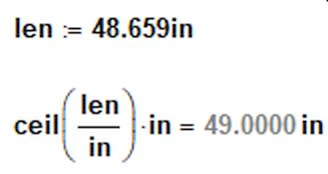

Jul 19, 2022 #1 hoshang Civil/Environmental Joined Jul 18, 2012 Messages 518 Location IQ Hi, How Ceiling is found for numbers associated with units using Mathcad? For example: Ceil (48.659 in)

Jul 19, 2022 #3 IRstuff Aerospace Joined Jun 3, 2002 Messages 44,911 Location US Mathcad converts EVERYTHING to its native units, which is SI. Therefore, even if a function allows for units, you should probably do something like: ceil(dimension/inch)*inch to preserve the dimensions desired TTFN (ta ta for now) I can do absolutely anything. I'm an expert! https://www.youtube.com/watch?v=BKorP55Aqvgfaq731-376 forum1529 Entire Forum list http://www.eng-tips.com/forumlist.cfm Upvote 0 Downvote

Jul 20, 2022 #5 rmix22 Electrical Joined Sep 13, 2013 Messages 92 Location AT Use scale:=1/mm instead of scale:=m/mm Remark: I am not sure if Mathcad 2000 already provided the built-in fuction "Ceil" (note the capital C). If its available in your version you can use it like "Ceil(18.2 mm, mm)=...mm" If not you may define your own: Ceil(a,b):=ceil(a/b)*b Upvote 0 Downvote

Jul 22, 2022 #6 EdClymer Mechanical Joined Jan 15, 2003 Messages 103 Location GB rmix22 I have checked the manual; and it says ceil (lower case) and it does work in that format. MathCAD 200 does have ceil and floor as built in functions. I hope this time the file is attached. Regards Ed Ed Clymer Resinfab & Associates England Upvote 0 Downvote
