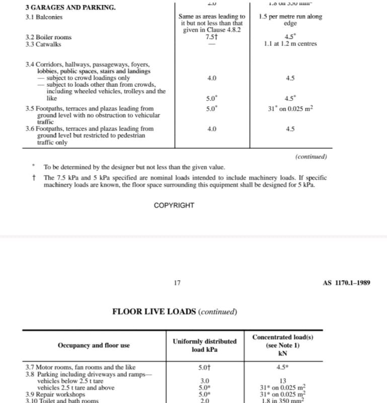

I can only go back to 1989. The numbers are the same but it's worded as loads other than crowds including wheeled vehicles.
I picked the parking/garage use category for the image because I was banging on about it earlier but the same load requirements are repeated in several other categories.
whenever i have gone down the path to look at live loads i have found most are historic.

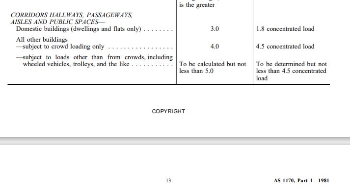

The 1981 AS1170.1 has more detail and alludes this to apply to hall ways/corridors (ie narrower spaces?) see attached extract

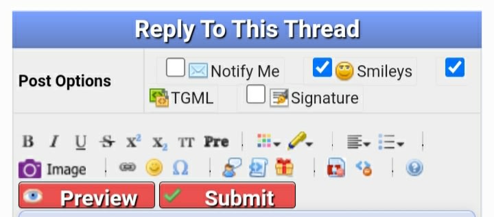

ps - how do you place a screenshot into a post?
Thanks, Blihpandgeorge. The attachment didn't arrive. There's a camera icon in the editing bar to insert images directly. See above the preview button (this is how it looks in phone, could be different on larger screen).
